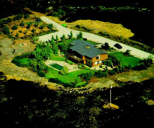

Thanks for the comments about wind-driven fires jumping what I thought was truly "defensible" space around a dwelling. So you're saying the kind of fire mitigation techniques illustrated in this picture won't work?
Saying they might not work. In this case, the property owner did everything right and still has a home to come back to. The trees to the left of the house are still too close for comfort. The swimming pool is great, though from the absence of tire tracks it looks like the fire department didn't need to get a pumper to it.
Which brings up another point. If you establish a fire fighting reservior like a large cistern or a pool, tell the local fire department so they can put it on their map. Water doesn't do any good if nobody knows it's there.

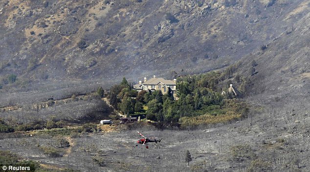

I wonder if elevation above its surroundings was the deciding factor in the amazing survival of this Utah home while all around it the wildfire decimated everything -- or maybe it was the lack of wind. It certainly doesn't look like the owners established any kind of defensible space:
Quail Fire: The Utah home left untouched by flames after wildfire rages through | Mail Online
   / Wildfire Protection #24
Probably what saved it was it's proximity to the slope behind it. That would tend to kill the airspeed on the ground at the base of the hill. It's one of the tricks in locating a tent camp in a windy area.

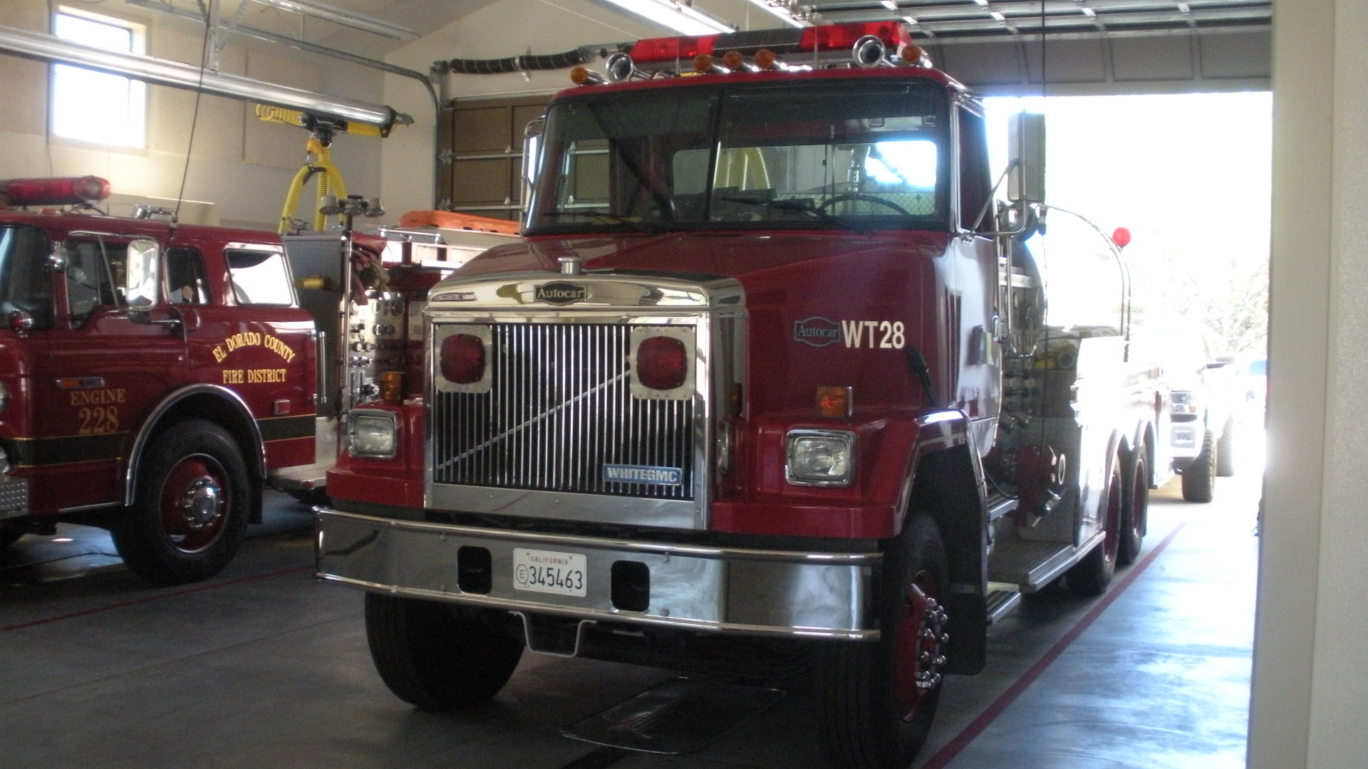

Finally, water tender; this is not an east vs. west thing, any more than wearing seat belts on every trip is. It is standard terminology for the English-speaking world, just like the terms above.
There are also helicopter tenders, fuel tenders, etc, etc.
Yet, I continue to hear folks east of the Mississippi insist that those big pavement queens are "tankers" as if they are trying to fight some sort of government intrusion into their lives by keeping outdated slang.(????)
Worse yet, those of us out west have puzzled for decades about the ongoing firefighter deaths back east as a result of not wearing seat belts while responding... Totally senseless and utterly avoidable.
Are the two connected?
...Retired fire incident commander (west coast)
