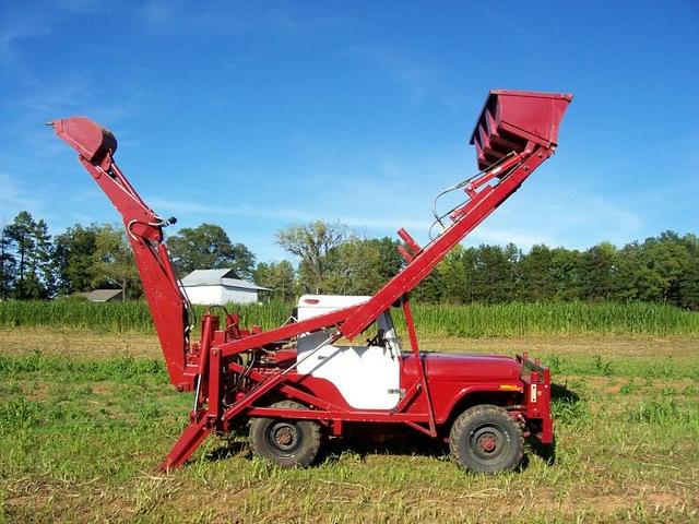

A neighbor has one as /pine pictured. 3pt hitch & pto & 4WD. Very cool. I don't think you'll do much plowing with a 2WD. I remember years ago as a kid seeing jeeps used on the highways mowing. Seen them set up as ditch diggers with a rear "ditch witch" style chain, and a few other "arrangements" that were odd. I think that someone posted one here that had a loader/backhoe set up a year or so ago.
Like these?
cj5_attachments_flickr.jpg jeep_backhoe.jpg wwwcj3a.info backhoe.jpg backhoe_trencher_cj5_brochure.jpg
Pictures from Google Image Search.
