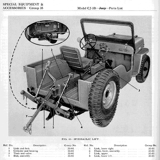

Hello everyone. I'm new to this forum and just wanted a bit of insight from all those that are experienced. I own a 2002 Wiley's jeep and was wondering if I could modify it and run it as a tractor. I saw a couple of videos of people in the US doing it and also found out that Wiley's themselves made a tractor jeep long ago. According to some basic calculations I did, if I add a secondary reduction after the gearbox the jeep should be able to produce enough traction. So is this possible ? Or am I missing something here a. And any idea why something like this doesn't already exist ? A car or jeep that can be used to plough and till.
Thanks in advance for your response.
We get this questions now and then at our Web site. I start by saying that it certainly possible to use a modern Jeep to pull a two bottom steel wheel plow and a pull type disc. In fact, the original Farm Jeeps were designed to use drawbar implements. The 3 point hitch was an add-on not made by Willys. Right after WWII the Farm Jeep was marketed to the small farmer who was still using horses or mules and he needed to be able to use the implements he had. So if you can find some antique farm implements you can use your jeep (or most 4WD pickups) as a tractor. How well they work is another matter.
From years of talking to farmers who owned used Farm Jeeps I think there were several factors that caused Jeep to not continue the farm jeep options. The biggest change was that farming in the USA really changed in the 1950s and 60s. Farms got larger and the days of 40 acres and a mule were long gone. More powerful powerful tractors were needed to work large fields. Jeeps farm market had disappeared.
Here is a great video that shows what I'm talking about - https://www.youtube.com/watch?v=MaVkRZL5G_c

Another point: Weight. A lot of traction, also known as tractive effort, is a function of weight.
You can have all the torque and horsepower you need, but if you can't hook it to the ground with a combination of wheel size, tread pattern and weight, all you'll get is wheel spin.
You also need to consider the effect of the rear suspension. Tractors have no suspension other than the cushioning effect of pneumatic tires. If you have leaf springs, some of the torque that you're trying to put on the ground to do work will result in twisting the rear end in the spring mounts and "winding up" the springs.
At the least, you'll have wheel hop. At the worst, you break the springs, universal joints or driveshaft.
None of the above is a "deal killer" you just need to think about matching your load to the amount of usable tractive effort you can generate without breaking things.
Hey thanks for replying
I realize that traction really has the biggest role to play here. And I'm honestly quite worried about my jeep rear crumbling down. And that's why i thought I'd confirm. What I probably will end up doing is just get a couple of ol and small tractor tires and modify my keep's rear end up a bit. Then try a 3 row plough with a normal draw bar hitch. Let's see how that works out.

There's an old trick used in the desert with 2wd cars in the 1920's and 30's to prevent wheel hop and loss of traction.
Jack up the rear of the vehicle so the axle is hanging. Cut some wood blocks so they fit tightly between the frame and axle, and wire them in place using holes and screws. Now you have a solid rear suspension that won't bounce.
It might help in your situation.
