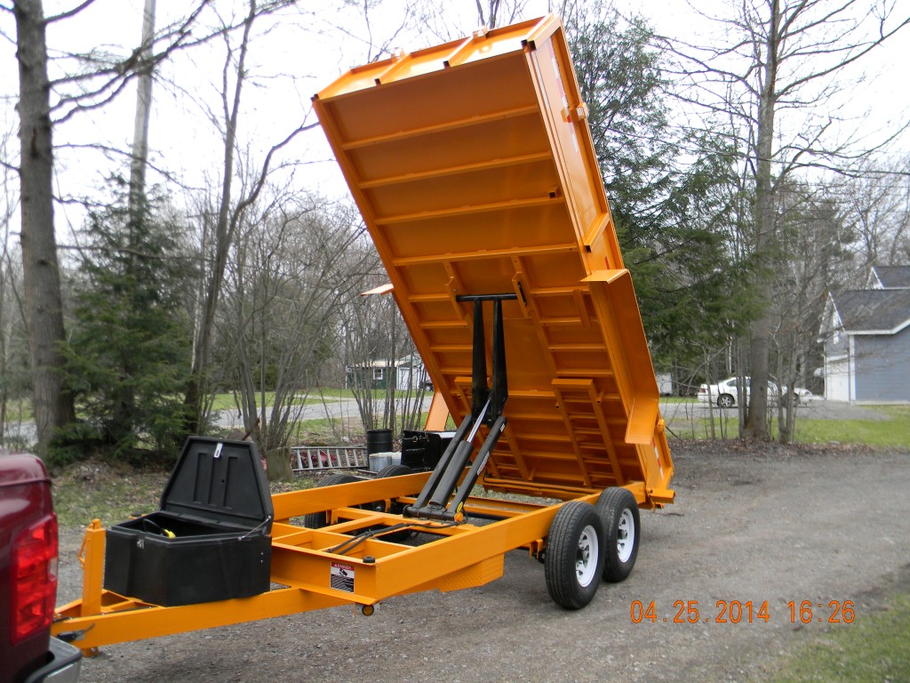

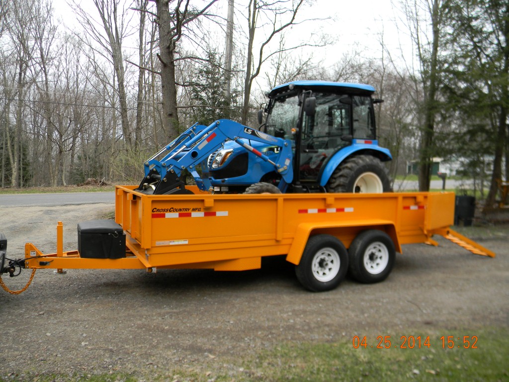

I have a 16' 14K dump trailer and NO, it will not dump 14K. Max load for my trailer is just over 10K. It uses a single cylinder powered by a 12V motor driving the hydraulic pump. Power up and down. A local gravel pit overloaded me one time (just over 12K) and it would not dump. I had to use a jack and 4x4 to start raising the front of the trailer and hit the raise button for the cylinder to catch up with the height. When it was about 4' high the hydraulics did take over to dump the load. After that, I made sure to never have them load over 10K.
What brand is your trailer? I don’t recognize it.
