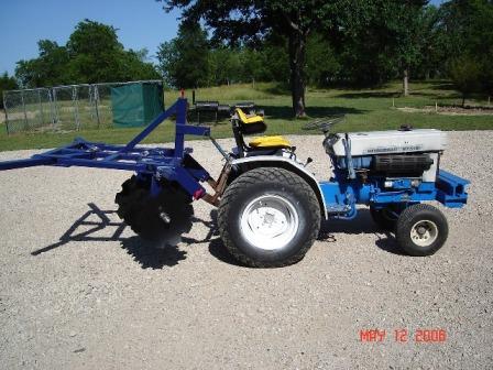

Sully2,
With all this talk of disking I couldn't stand it any longer I had to try out my disk even though it only has the two ft. gangs, I hooked it up to my 16hp 2wd Mitsubishi tractor just to see what it would do.
I had the gang set at the highest angle, when I dropped it down it was like throwing out a boat anchor /forums/images/graemlins/crazy.gifso I adjusted it to the second lowest angle setting and it would pull it.... straight not in a tight corner.
It did a fair job for about 20min of draggin.
When my other two axles finally show I'll finish it up with the Kubota...it was still fun though /forums/images/graemlins/grin.gif
Just like Eddie said it will work.
