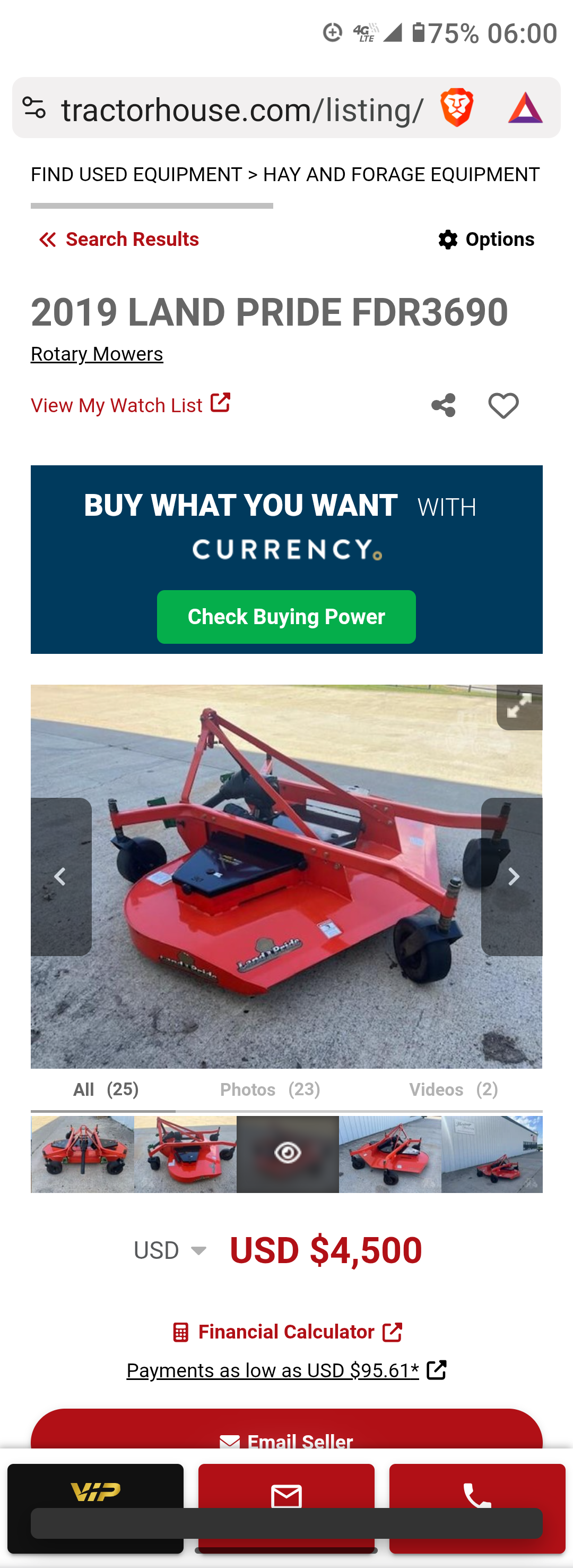

I recently bought a Kubota L3560HSTC tractor. I'm looking at finish mowers for my property and the Land Pride FDR3690 90" finish mower falls into the "go big or go home" category. Looking at their product page they say that the mower requires 30-70HP. My tractor has a 35HP motor but the PTO is only 28HP. One thing I haven't figured out yet is which HP Land Pride's site is referring to when they list their attachments. I'm wondering if this mower would work on my tractor without issue, or if it would be a struggle and I should look at something smaller.
