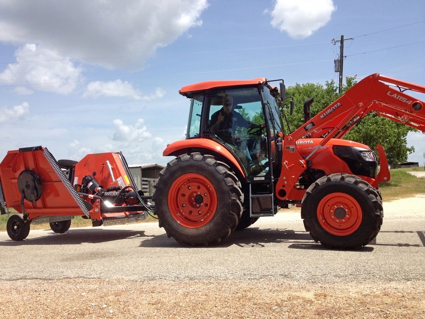

will a M7060 handle a Howse HD 10 bush hog
   / will a M7060 handle a Howse HD 10 bush hog #11
You have enough tractor so long as the field isn't too overgrown. If the field is high, you don't have enough balls.
If grass/weeds is very high operator could choose lower gear & if it's still too much load on tractor take a smaller cut!
   / will a M7060 handle a Howse HD 10 bush hog #12
I have a kioti 7320 which is about the same power and weight as your Kubota and pull a 3 point 10.5 foot Shulte shredder and it does great. I am thinking about getting a 12' batwing - the super wide 3 point mowers can be a little rough on the ground (edges like to dig in if the ground is uneven).
   / will a M7060 handle a Howse HD 10 bush hog #13
Howse declared bankruptcy and liquidated about eighteen months ago.
You will have to adapt gearbox parts from another brand.
Howse used gearboxes made by others.
Should be able to get parts for years to come.
Bingo. 12' BW cutters, two 4's and one 5' follow the ground very well and do not pull hard.
They also take up little room in the barn.
I recently shopped both 12' and 15' BWs. Really, really wanted the new LP 3512 HD 12' cutter with optional built in OR clutch but it would have cost nearly $3,000 more than the Woods BW 15.50, 15' cutter that I did buy.
I just got the 12' and it works great.
