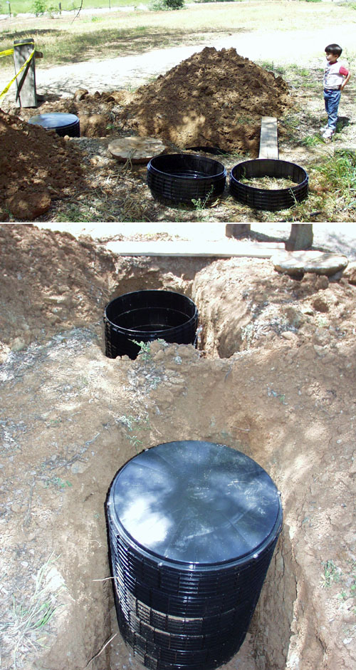

   / Will a septic tank support a BX2200? #36
Re: Will a septic tank support a BX2200?/READ THIS
<font color=blue>$75.00 if we opened up the tank</font color=blue>
That's the way to go! Bringing in a backhoe to open ours up brought the price tag into the hundreds, so I went ahead and installed plastic risers (see attached) which are now only a few inches below the surface. In fact, access is so easy at this point that I could inspect them myself if I knew what to look for. Other than crud climbing right up out of the hole, can anybody tell me exactly what visuals indicate when it's time to call in the service?
