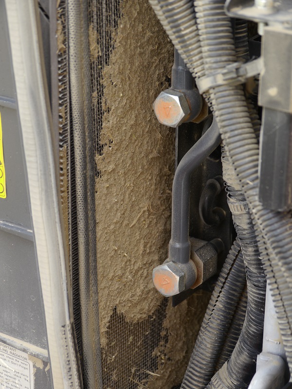

Just finished mowing ~ 50 acres of cheatgrass - very dry, very dusty conditions and the main reason I bought a tractor with a cab this time. Here's what my radiator screen looked like after 5 hours of mowing; I noticed the temperature gauge was starting to creep up:
I also make sure that before the tractor is put away for the evening, all screens are removed and cleaned and then the radiators and coolers are blown out with compressed air. I have a long air lance with a right angle bend on it just for this purpose. For some reason the cooler and a/c condensor in front of the radiator accumulate only a small amount of debris compared to the radiator and I'm guessing that's because of the powerful pull of air from the fan.
My old John Deere has no screens protecting the radiator but same procedure - at end of day the radiator got blown out - and the amount of dirt that would come out after just a few hours was amazing!

I use a long air wand made by Milton. They are a bit expensive but the cheap ones from HF do not hold up. I have two and consider them just about essential.

That looks familiar. I used to mow about 3 acres with a BX22 and would have to stop and blow it out 2 or 3 times. Now I mow with a ZD21 and can usually make it without stopping, but not always. Seems like everything that grows here has seeds perfect for plugging radiators.
