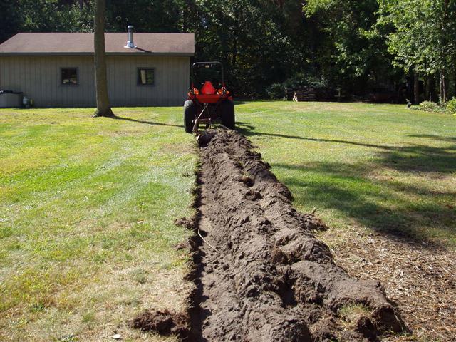

I have a Kubota B3030 ( I know, wrong forum, but I also have a JD 318, so please cut me some slack /forums/images/graemlins/grin.gif) and I can pull a 2 x 14" plow in sandy ground with no problem. I think my tractor is comparable in size and weight to yours. I do need to be in 4WD and have the loader on for weight. It pulls it better than I thought it would, 7 to 8 inches deep. I don't plan on doing this very much but I had a lawn remodeling job to do and the plow broke up the sod so I could push it around easily with the loader. In the future I'll just use it to plow the garden every year.

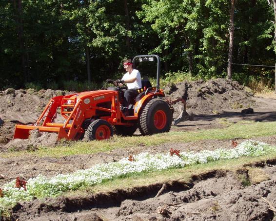

Using the FEL after some plowing.
