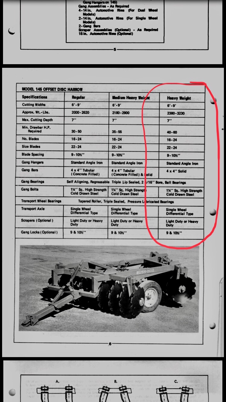

If your referring to my post I might have exaggerated at little. My disc weighs 2400-3200 according to the width. A 6’ 16 disc weighs 2380 lbs and a 9’ 24 disc weighs 3230lbs. Mine is a 7’ with 18 24” disc. My guess is that the disc weights around 2500 and I have approximately another 400lbs of weight added. So around 2900lbs.
I tried to attach a photo of the manual but I can’t get it to cooperate.

Have you got a picture of the disks? The weight you mention is about what the forestry disks are supposed to weigh.

I don’t have one on my phone anymore but I found one like in for sale on Tractor House.
https://www.tractorhouse.com/listings/farm-equipment/for-sale/17872619/bush-hog-145
Here is a picture from the manual that gives the weight of the disc. There are several variations. I circled the one I have in red.
