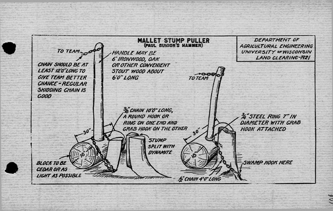

Here is one way to do it. You can use your tractor instead of a team of horses or oxen. :D
