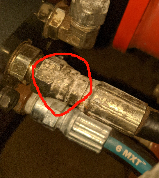

So I'll need to disconnect this hose to reconnect it to a T afterward. It's the loader return to tank hose. I think it has a swivel connector but it seems to have aged quite a bit and not sure if it will be an issue to remove. Will it give problem? Is there something I can put over it to loosen it?

I would spray it with some penetrating oil and let it sit some time. Should help a little bit I think.
   / Will this connector give me issue when trying to remove it? #3
Should be fine, just use two wrenches. No pressure build up on a return line.
   / Will this connector give me issue when trying to remove it? #4
Looks like the salt water corrosion I used to get on my sailboat. No big problem with the metal of fittings, but the corrosion itself was sort of like hardened glue.
What I would do is dribble some boiling water on it to dissolve the corrosion while using a little wire brush to pick at it & knock off what I could. Then dry it off &put a few drops of penetrating oil on it.
Give it 5 or 10 minutes & then loosen it slowly to allow any unseen corrosion to fall out.
When re-assembling I smear the fitting outer surface with any good natural car wax (good waxes contain carnuba wax) to slow down the same thing happening quite so quickly again.

Are you SURE your kioti has NPT threads? Your pic looks to be JIC connections to me. Granted, I know NOTHING about Kioti tractors, other than the sparse info on tractordata.com...
Also, from your pic it seems like a branch tee would be the LAST thing I would do. Even if your connections really ARE NPT, a RUN tee would give you a slightly extended male and a right angle male, so at least ONE of your new tank returns wouldn't change much in the way of hose routing... Steve

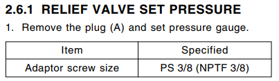

Edit: There is no mention of JIC in any of the user, parts and service manuals for the tractor and neither in the backhoe and loader manual. NTP is mention once in all those manual and it's for the auxiliary block relief valve in the service manual.
Is there a sure way to tell, beside unhooking the hose?

Well, it does look like this fitting...
Except the one below what I circled. It has Teflon tape so, unless that dealer is clueless and added Teflon tape to a JIC fitting, it's a NPT.
