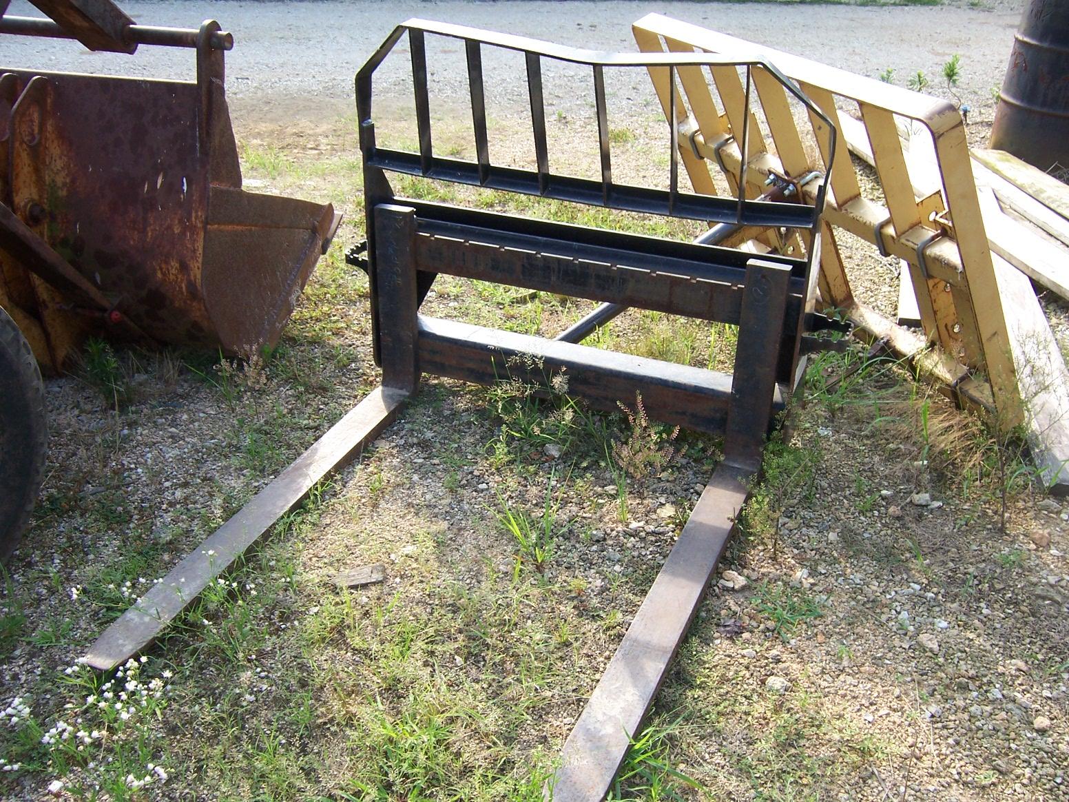

Will this set of John Deere pallet forks with whatever type of QA it has work with my Bobcat CT335 QA plate and lock on?
Seller says it will work with skid steer and I believe the CT335 uses the same plate as the skid steer.

Don't know why it was a tiny pic.

JD tractors use some funky proprietary JD hookup.
unless it was for a john deere skid steer in which case it should have a standard skidsteer attachment.
/ Will this Pallet Fork work? #4
Not all of them, some use the standard SSQA.
/ Will this Pallet Fork work? #5
yes, this is true. The 4x20 series offers SSQA on their FEL, i think it is an option for the 300cx. it will fit your bobcat if it has SSQA.

So I gather I need to get another picture showing the attachment points, yes?
/ Will this Pallet Fork work? #9
I think a picture of the back a little larger would help. But if you own a welder and a 4 1/2 grinder I would say you could make them fit.
/ Will this Pallet Fork work? #10
yes another picture, but it should work with the regular type hock up but not if it has the JD specific.
