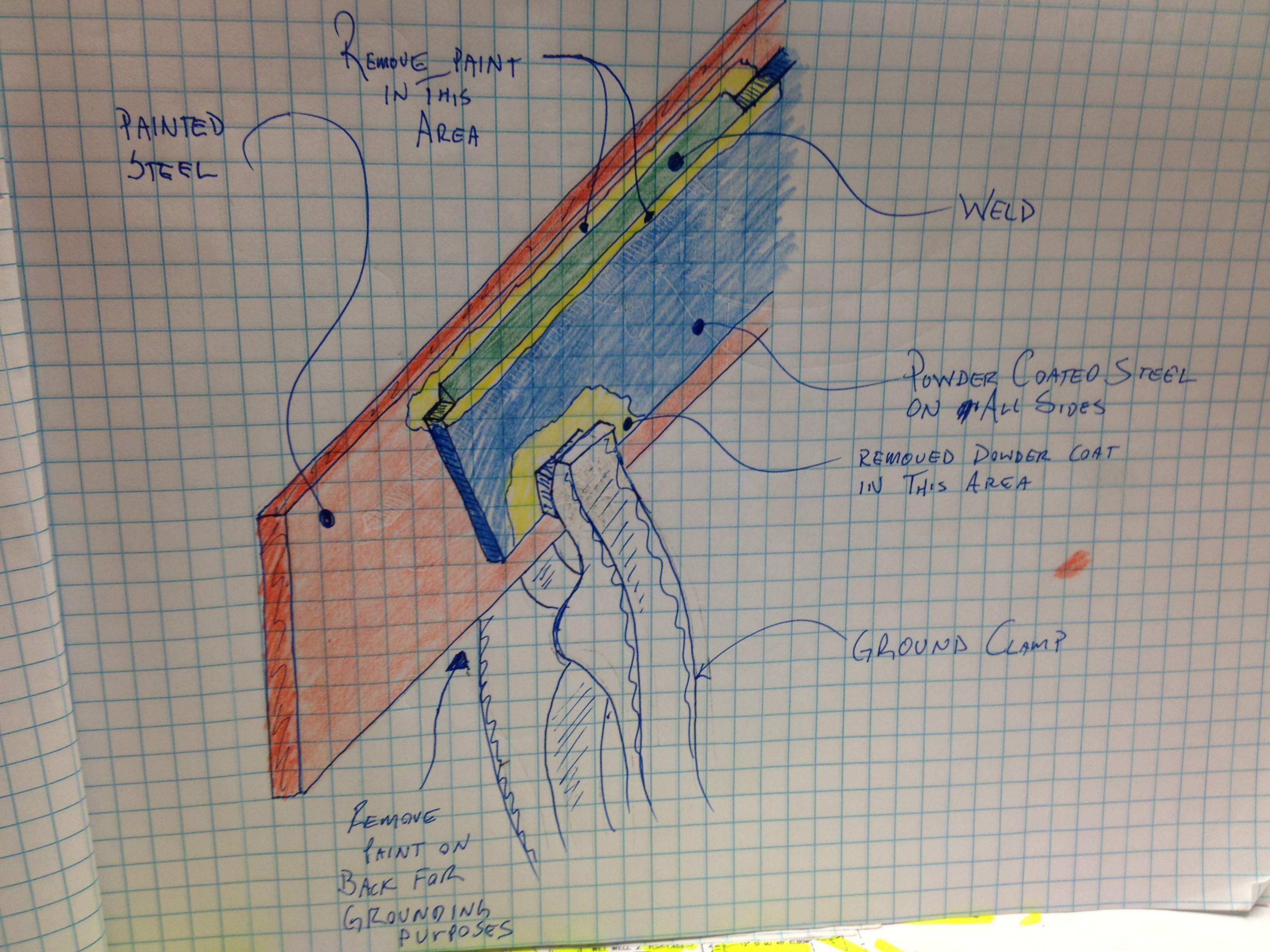

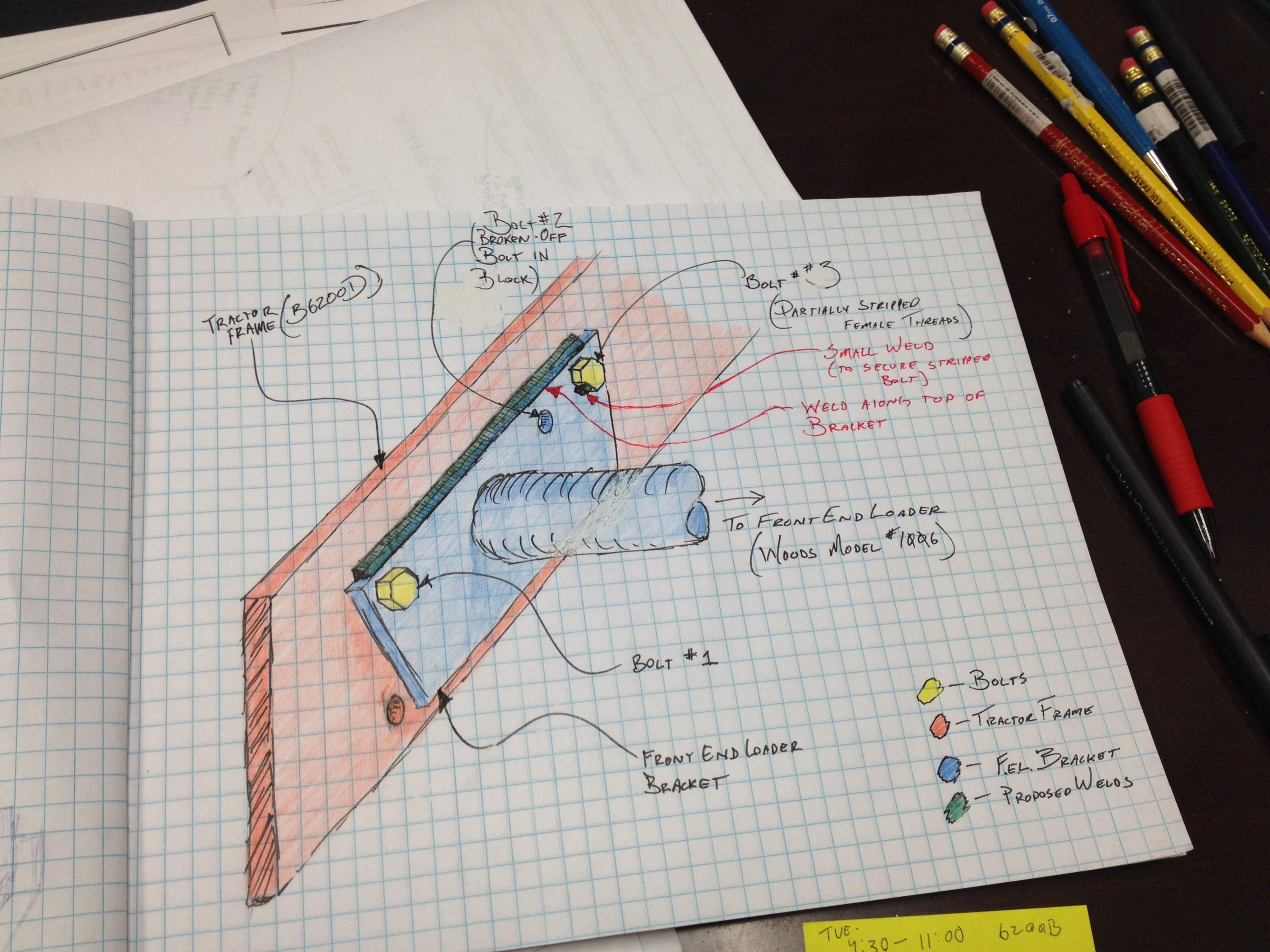

Do you guys think the proposed method in the first sketch will work? the two pieces of steel are already affixed together, so taking them apart to prep is out of the question. Ill attach a second sketch to give you an idea of what i am doing.
Thanks

Just to be clear, the problem is that you have some stripped bolt holes in your tractor frame, and you want to secure the loader frame to the tractor frame permanently with welds?
/ Will this work? If not what will?
This is correct. I don't want to remove the loader frame from the tractor frame, to strip the powder coating, because i don't want to chance completely losing "Bolt #3's" threads. And I fear not having a good ground by just connecting the ground clamp to the tractor frame alone because I assume that continuity between the two pieces of material is not present because of the layer of powder coat that is sandwiched between the two.
/ Will this work? If not what will? #4
I think your assumption about grounding between the pieces is correct. You could test this with a multimeter if you really cared to, but grinding clean both sides and then clamping to them should create the necessary continuity, since one side of the clamp will be touching each of the pieces. Here's an alternative, that will save you from grinding off very much powdercoat from the loader frame: grind clean the back surface of the frame, then clamp as depicted in the drawing. Grind clean the paint/powdercoat from the joint, then strike an arc on the frame side of the joint and carry the puddle over to the loader frame, creating a tack. Once the pieces are tacked together, there will be ample continuity.
/ Will this work? If not what will? #5
Bolt #3 will be grounding the two pieces together. Wire wheel where you are going to weld. The powder coating will be slag when you run the weld. Another method would be tapping the existing holes for a bigger bolt. If bolt #3 has questionable threads; do the first holes and then back #3 out and do that one oversize also.
/ Will this work? If not what will? #6
I think you're trying to avoid welding out of position by only putting a single bead on the top, but I do have to wonder whether a single bead will provide enough strength to replace the missing bolts. It's surely not how a manufacturer would have welded it up.
/ Will this work? If not what will? #7
I have to agree with Josh that only welding the top will not be strong enough. Are these blind holes or can you drill them through and use a bolt and nut to hold the frame on? If something goes wrong with the tractor and you have to split it, would this frame prevent you from doing that?

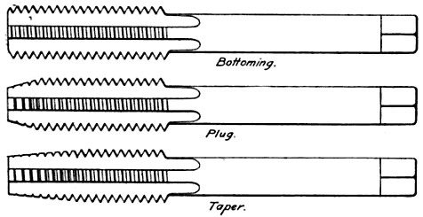

From:
Tap and die - Wikipedia, the free encyclopedia
Bottoming tap or plug tap
The tap illustrated in the top of the image has a continuous cutting edge with almost no taper — between 1 and 1.5 threads of taper is typical. This feature enables a bottoming tap to cut threads to the bottom of a blind hole. A bottoming tap is usually used to cut threads in a hole that has already been partially threaded using one of the more tapered types of tap; the tapered end ("tap chamfer") of a bottoming tap is too short to successfully start into an unthreaded hole. In the US, they are commonly known as bottoming taps, but in Australia and Britain they are also known as plug taps.

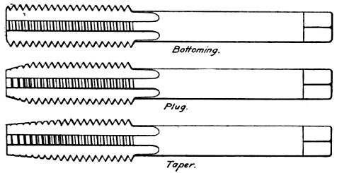

From:
The tap illustrated in the top of the image has a continuous cutting edge with almost no taper between 1 and 1.5 threads of taper is typical. This feature enables a bottoming tap to cut threads to the bottom of a blind hole. A bottoming tap is usually used to cut threads in a hole that has already been partially threaded using one of the more tapered types of tap; the tapered end ("tap chamfer") of a bottoming tap is too short to successfully start into an unthreaded hole. In the US, they are commonly known as bottoming taps, but in Australia and Britain they are also known as plug taps.
Nice! I was only aware of the taper type die. The 2nd hole I illustrated has a partial bolt broke off into it though with nothing exposed. In fact its embedded Im guessing about 3/8 of an inch. I tried a few different extraction methods to no avail. And Im paranoid to drill top much because the engine block is what Im attaching the bolts to.

Ok. You have some stripped threads in an engine block, and a broken bolt in another.
First lets deal with the broken bolt.
Was it broken from side load or bending over, or was it broken from twisting?
If from a side load, that's good. It can likely be removed without too much trouble. You might try using a cold chisel to turn it out. If you have enough bolt left, you could weld a washer to the broken end and then weld a nut to the washer. The heat from the welding will help to free the bolt too.
Now for the stripped holes in the block. What you need is a heli- coil thread repair kit for that size thread.
The kit will come with the right size drill and special tap. You drill out the rest of the damaged threads and then use the oversized tap to cut new threads. Then you use the installation tool to screw in the heli-coil. The coil looks like a spring, and will fit into the newly tapped hole. When in place the inside of the spring will be the same threads as the original threaded hole.
