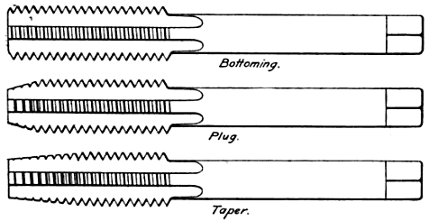

#13
From:
Tap and die - Wikipedia, the free encyclopedia
Bottoming tap or plug tap
The tap illustrated in the top of the image has a continuous cutting edge with almost no taper between 1 and 1.5 threads of taper is typical. This feature enables a bottoming tap to cut threads to the bottom of a blind hole. A bottoming tap is usually used to cut threads in a hole that has already been partially threaded using one of the more tapered types of tap; the tapered end ("tap chamfer") of a bottoming tap is too short to successfully start into an unthreaded hole. In the US, they are commonly known as bottoming taps, but in Australia and Britain they are also known as plug taps.
Nice! I was only aware of the taper type die. The 2nd hole I illustrated has a partial bolt broke off into it though with nothing exposed. In fact its embedded Im guessing about 3/8 of an inch. I tried a few different extraction methods to no avail. And Im paranoid to drill top much because the engine block is what Im attaching the bolts to.
