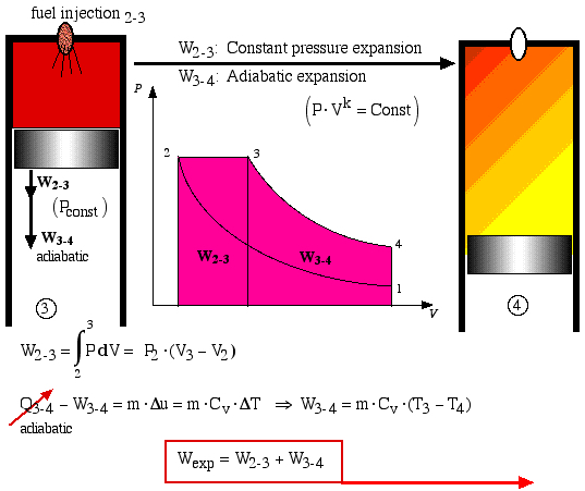

Think of the crankshaft as a lever being pressed on by the connecting rod. The further the rod is pushing away from the crank centerline, the greater the leverage or torque. Short stroke high rpm diesel equals poor performance.
Attached is a perfect diesel cycle. Piston reaches top dead center and heat is added (fuel injected) keeping cylinder pressure high until mid stroke. The result is lots of leverage but a controlled burn. In basic terms, heat added at a constant pressure. The Otto cycle (gasoline engine) has heat added at a constant volume (TDC) and that peak pressure drops as the piston goes down. The result is lower torque, and to make up for it add cycles (higher engine speed). It's a simplification but for comparison, a Ford Ecoboost 3.5 has 365 HP and 420 ft lb while the 6.7 Powerstroke has 420 HP and 925 ft lb. both are direct injection. Max power at 5,000 vs 2,800. Remembering the old days and our gas tractors (maybe not so old as we still have 4 gassers around the place) they don't really get down and grunt when we hit a hard pull. They die. Most of our diesels really bear down and pull through.

Think of the crankshaft as a lever being pressed on by the connecting rod. The further the rod is pushing away from the crank center line, the greater the leverage or torque. Short stroke high rpm diesel equals poor performance.
Correct, the reason a short stroke diesel is inefficient is because you need the longer stroke to take advantage of the longer burn time. One needs a longer stroke than the other.

The determining factor is the length of time it takes the fuel to burn. Diesel fuel takes longer to burn hence lower rps. There are ways to cheat like a pre combustion camber.
Actually not . It is the short direction cam timing and the small valves from a small bore/long stroke design that choke of high rpm power due to the engine not being able to empty and fill the combustion chambers .
