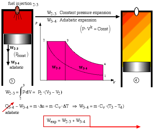

Think of the crankshaft as a lever being pressed on by the connecting rod. The further the rod is pushing away from the crank centerline, the greater the leverage or torque. Short stroke high rpm diesel equals poor performance.
Attached is a perfect diesel cycle. Piston reaches top dead center and heat is added (fuel injected) keeping cylinder pressure high until mid stroke. The result is lots of leverage but a controlled burn. In basic terms, heat added at a constant pressure. The Otto cycle (gasoline engine) has heat added at a constant volume (TDC) and that peak pressure drops as the piston goes down. The result is lower torque, and to make up for it add cycles (higher engine speed). It's a simplification but for comparison, a Ford Ecoboost 3.5 has 365 HP and 420 ft lb while the 6.7 Powerstroke has 420 HP and 925 ft lb. both are direct injection. Max power at 5,000 vs 2,800. Remembering the old days and our gas tractors (maybe not so old as we still have 4 gassers around the place) they don't really get down and grunt when we hit a hard pull. They die. Most of our diesels really bear down and pull through.
Not so. Per cubic inch even the old carburated gas farm tractor engines mad more power and torque than the natural aspirated diesel . Check the Nebraska tests if you don't believe me.
With the same cam , same cylinder head , same compression and same displacement engine . The small bore/long stroke engine makes the same power as the short stroke/large bore engine .

The determining factor is the length of time it takes the fuel to burn. Diesel fuel takes longer to burn hence lower rps. There are ways to cheat like a pre combustion camber.
Actually not . It is the short durection cam timing and the small valves from a small bore/long stroke design that choke off high rpm power due to the engine not being able to empty and fill the combustion chambers .

Actually not . It is the short direction cam timing and the small valves from a small bore/long stroke design that choke off high rpm power due to the engine not being able to empty and fill the combustion chambers .
Agree and the reason it is two short is because the fuel takes longer to burn than gas. You can cut the time needed down for scavenging(which is what I believe you are talking about) by adding a turbo on a diesel or making exhaust valves bigger or adding exhaust valves. They also use a pre-combustion chamber which helps. At the higher rpms you just do not have the time to get the fuel to burn complete enough in the time given, before the exhasut valve has to open. Slow the diesel down get your road speed by adding more gears now your getting somewhere. It would be interesting if you could get a CVT transmission to hold up behind a diesel, that would get you the needed gearing to run low speed high torque diesel in automotive application.
No discernible difference.
No
Yes
only for starting a diesel with low compression pressure due to having a long duraction cam to allow improved volumetric efficiency at "high rpm" for high rpm power.
At the higher rpms you just do not have the time to get the fuel to burn complete enough in the time given, before the exhaust valve has to open.
No
There is "too slow" of rpms. Lowers combustion chamber temperatures .
CVT wastes power due to friction losses. Best compromise is the 6,7,8 or 9 speed auto transmissions with a lockup torque converter.
