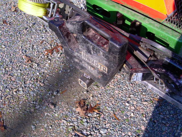

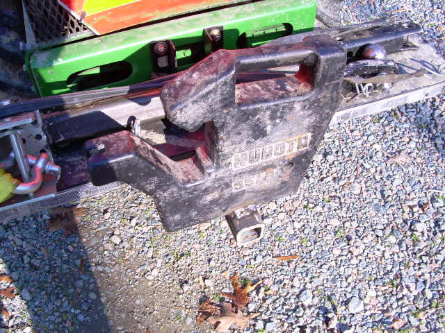

I got the PT stuck today. As usual no pictures. I was trying to recover some of the gravel that had washed off of my culvert. I attached the minihoe and drove down into the creek and then realized how dumb this was. I could not go backward or forward even using the minihoe (well maybe a little). I was throwing mud all over me and the PT. I got out and hooked up the boat winch to the back and the other end to a tree. I had to put the strap on the tree up high to lift the PT and not just pull it back into the bank. I also had to change trees once to make the PT miss the culvert. It took about 20 minutes to get everything hooked up and get in and out a few times. I would tighten the strap, get back in and drive backward while pushing the PT back and up with the minihoe. I did this several time. I got out, but covered in mud. I got to thinking how the hydraulic winch would have done. It would have been better, but probably not that much. I have to have a good way of attaching the winch to the back (that's where I usually recover from) and run it back there. My previous concept should work. Anyway: Creek 1, Bob Rip 0.

I ordered the winch today. I will modify it after I test it for awhile. Actually my modifications should be made so I don't really change (drill, weld, or cut) the winch. That way if it fails I can reassemble it and get covered under the warranty. Actually I could probably just send the part that broke part back to PT and they would send a new one. Still I like to have an undo capability.
I would like to put a longer cable on it. Maybe I should just get a long piece of blue synthetic cable and use it. I assume I will not need to have a metal lead in. Could I just splice the blue synthetic cable to the existing wire cable? I need some ideas here.

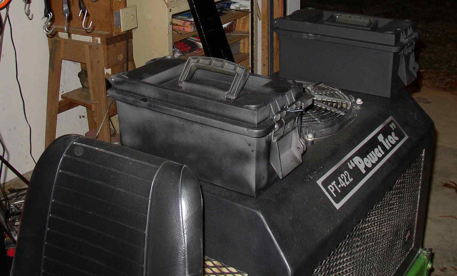

Where in the heck do you carry anything on the PT. I know, the roof of the tractor.... But it is quite high up on the 1850. Not easy to put a chain, chainsaw, gas or other stuff.
I wish for a safe spot that I could put a hammer, a wrench, a screwdriver and a chain that wasn't in the way of something else, and easy to get to.
Carl,
As I was driving home last eve I was thinking about mounting ammo boxes to our new beast. I haven't taken the measurement yet but I'm pretty sure we can mount them to the sides (bolted to the hydraulic tank) just forward of the rear wheels, a few inches up from the bottom of the pan for better clearance. Easy access...kinda like saddle bags ;)....
   / Winch anchoring #33
Carl,
Great idea! You'd have to paint it PT colors, though.
-Rob :)
   / Winch anchoring #34
Carl,
Its a good idea... some downsides.
This PT is very low, and goes everywhere. I think this area will get banged up a lot.
That said, this is where I stand to lift the hood. I am not sure how the other PT's are, as I have never seen one in person, but the hood is frikin heavy. I really have to gut it to get it up. I notice I stand right where the ammo boxes would be placed...
But... All of this can be worked around....
