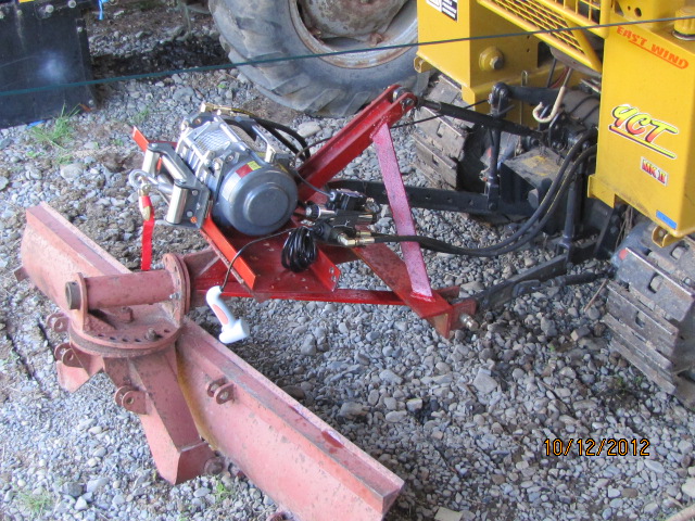

Runva electric winches look a lot like a Superwinch, maybe they're made in the same place. After using mine for a couple hours, the idea that it would be a temporary installation is out the window. I think I'll order another snatch block so I can use two, one up high on the tree dragging end, and another down low, so I don't lift the tractor. Besides, using one looks too much like a sling-shot aimed at my head. I have to skid pan it too, to protect the wires on the bottom. I would have mounted it the other way, but that would have put the cable slot on top of the mount and weakened it. (probably could have wound the cable the opposite way on the drum, and run it backward, now that I think of it.. 20:20 hindsight) anybody know if the winch cares?
On my Landcruiser I have a 9000-pound Come up electric winch that was made in Taiwan I believe they also make the gearbox and drum for Superwinch. I have been told Superwinch assemble with an American motor wire rope and a few other parts to get it up to the correct percentage so they can label it 杜ade in USA
The Runva winch is of similar design but much heavier with cast steel casing痴 fine on a bulldozer but would be to heavy on a 4x4 front bumper the Come up winch has alloy casing and not so hard on the Landcruiser front suspension

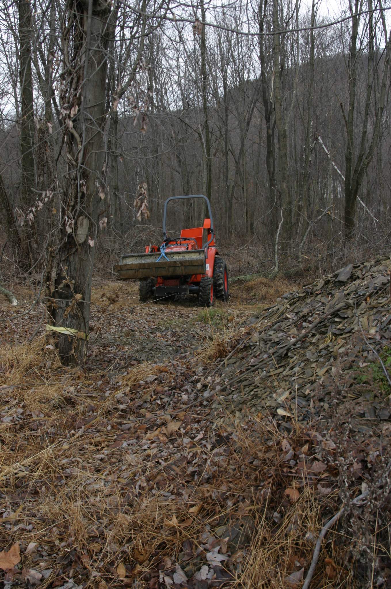

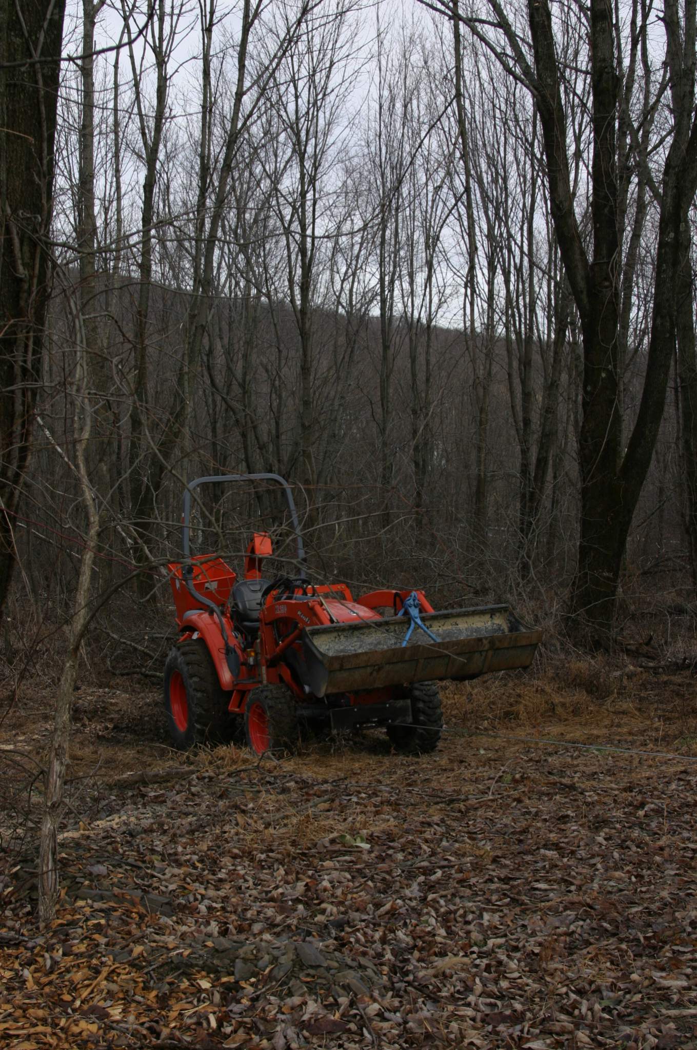

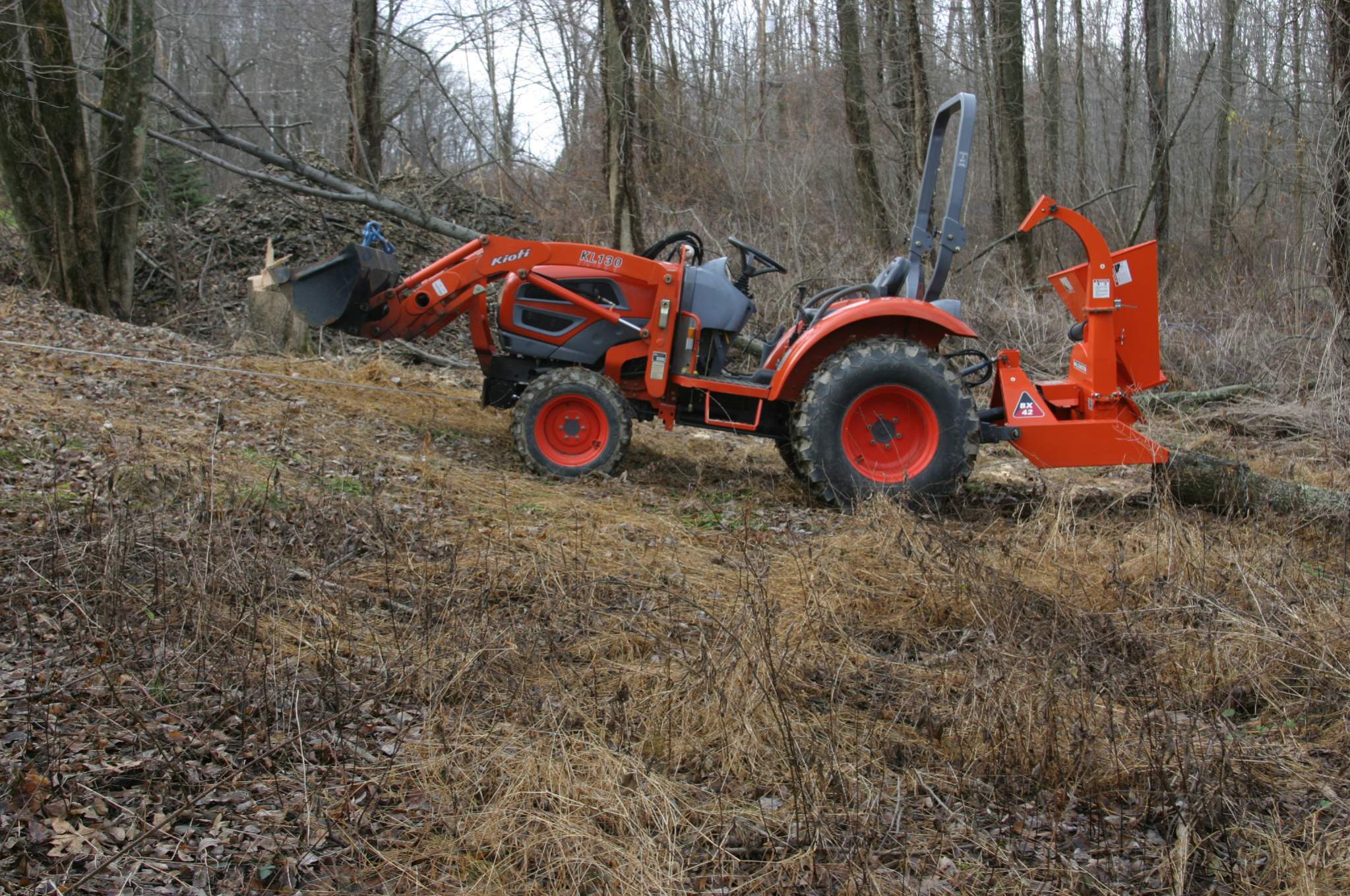

I put the bucket up against another tree, (I'm not a total idiot..) that's why I put the winch on the front. :laughing:
