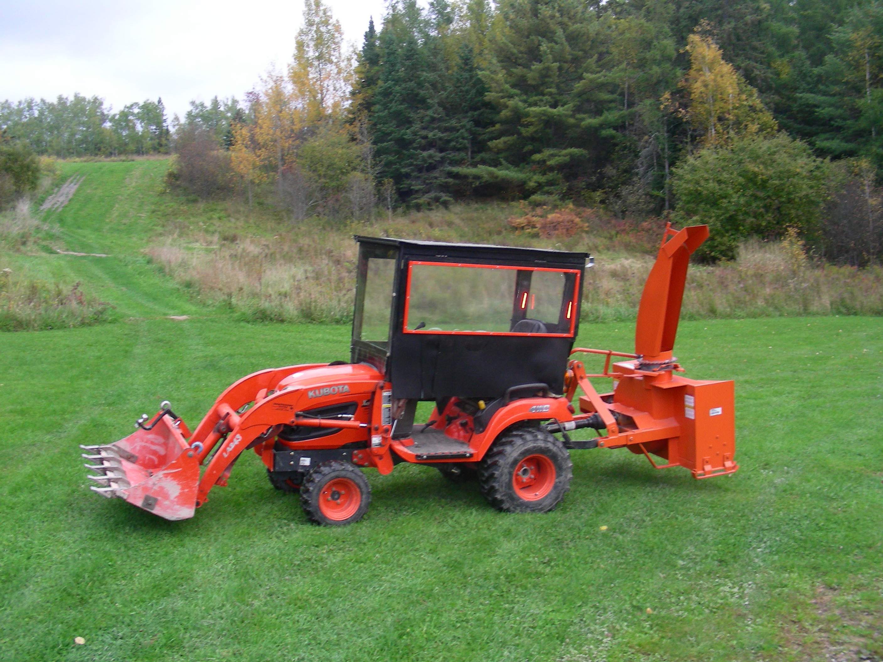

Okay I have seen a few of you folks have used a car electric window motor , to rotate your snowblower chutes........but has anyone tried using one of those motors to move the chute deflector up and down. Or does anyone see problems that would arise if I try doing it.
See my picture attached............as you can see I don't need to have a electric chute rotator , because I can do it manually from my seat by reaching thru the cab rear felt cloth and turning the crank.
But I still have to get off my machine and comfort of the cab to change the chute deflection angle. The chute deflector has a very robust steel rod and attachment points and if I had easy access in Canada to a (under $100) linear actuator I would use that route, but I have not found one............but a electric window motor from scrap yard looks tempting and cheap.
What thoughts from others ?

Why not.
Just install a pulley on the motor shaft and use a wire with spring.
The spring will keep the chute in a default angle.
Change the chute angle by operating the window motor.
Reverse the window motor back to default angle.

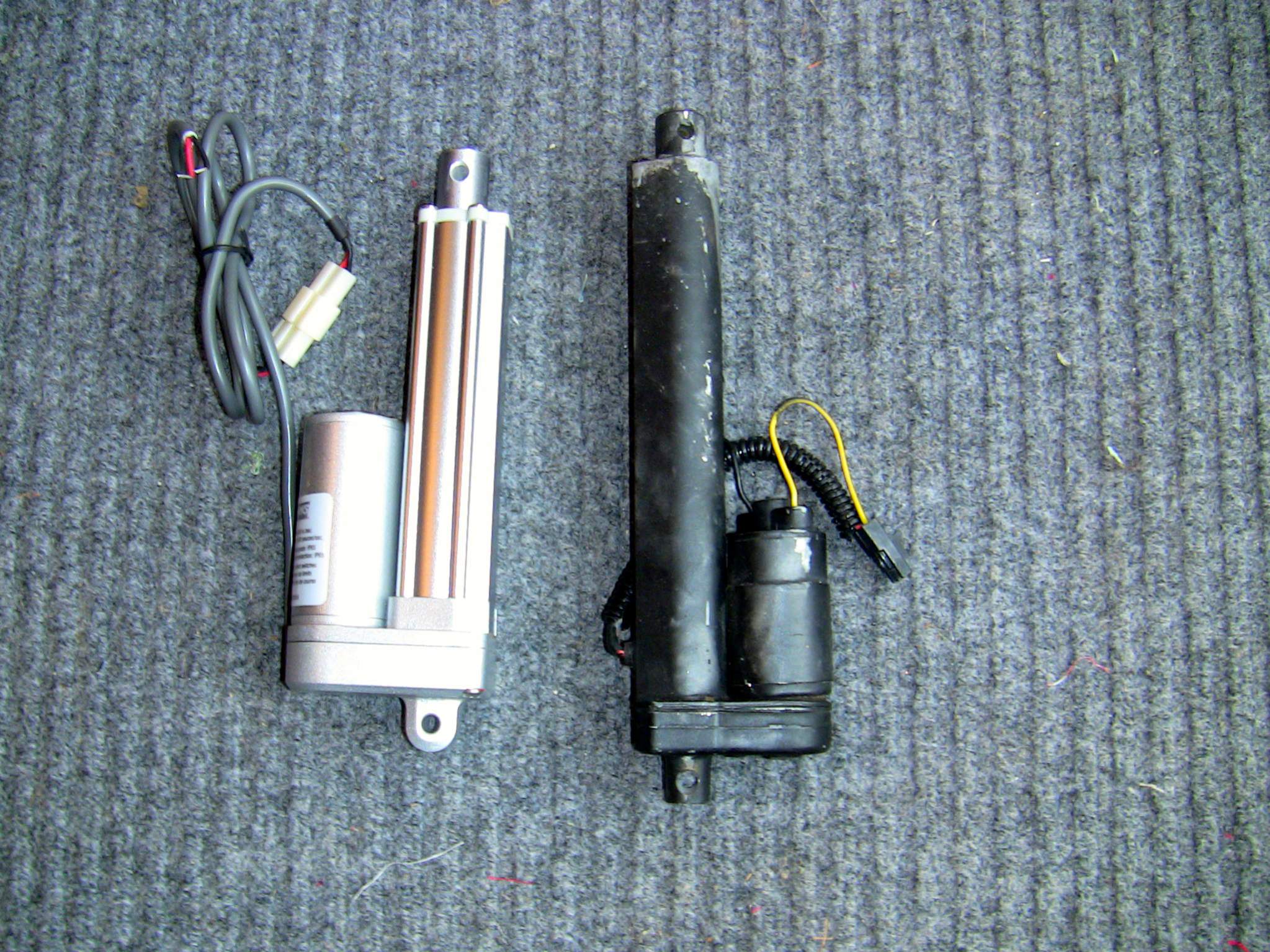

I installed a 12volt linear actuator on my previous Kubota (from eBay), worked fine. The car window drive motor works better for chute rotation. You can couple the motors gear to the original mechanical drive "worm" gear using a short length of heater hose. Use a stainless steel hose clamp on the gear end and a through bolt on the work gear end.

Here's a pic of my old and new linear actuators. I bought the new one a week or so ago at Princess Auto for $70. It has a stroke of 4 inches and max load of 270 pounds. As you can see the new one is somewhat different in physical size but should fit just fine on my BX25 rear mounted snowblower. The old unit was mechanically damaged when I rammed the deflector into a hard snow bank.

I just finished an electric chute rotator with a power window motor $10 from the bone yard. Perfect speed and very happy with results. Now I am thinking about motorizing the deflector. There is a huge selection of linear actuators on ebay which seem reasonably priced $50-60. Maybe one of these could be an option for you.
Here's a video of the new linear actuator installed on the snow blower. As you can see I had to make up a little adapter to allow for the differences in physical dimensions and stroke length.

A linear actuator can be had on eBay for well less than $100.
On the switch thing, I went to a fair amount of effort to locate a Joystick type switch, one that was robust enough to handle the motor current under load. The joystick was about 2 inches long and not that convenient to use with winter gloves.
In retrospect I would suggest using two DPDT (double pole double throw), center off, momentary toggle switches. One oriented with toggle up and down for deflector, and the other sideways for chute rotation. Wired like this:

I have fooled around with a variety of 12 volt shoot drives and have to say that you do want a lot of low speed torque as ice occurs and you do need power to break the shoot loose.
In my case I presently use a wheelchair traction motor and that performs just great as would a small electric winch motor.
Unless you park indoors in heated garage I think window and seat 12 volt motors will not cut it.
At one time I used a chain and sprocket arrangement but ice between the links made that impracticable so I went to a cable wrap driven by a small motor drum with the best results.
