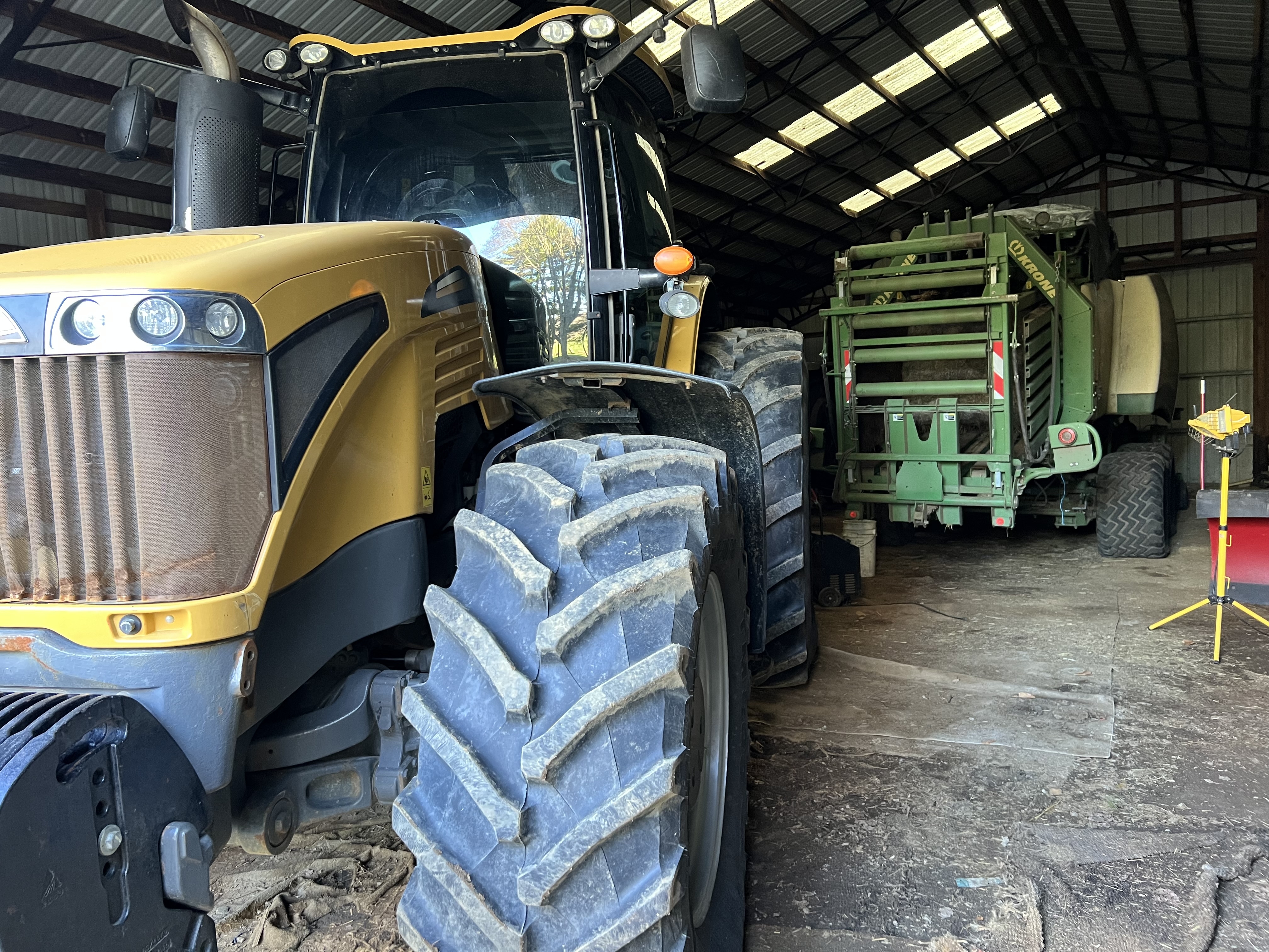

I do believe he is talking about the fuel tank on his Challenger tractor, not a bulk storage tank. Fuel tanks on the bigger Challengers hold up to 400 gallons!
And I ***** when I have to fill the 23 gallon tank on my Kubota!
