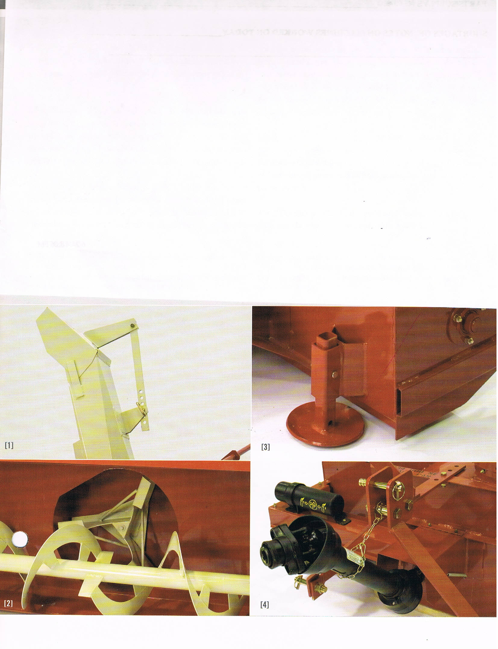

the snow blower saga continues:
a lot of people have front blowers with only rear chains and unloaded tires we did for a long time with our cub cadet years ago as well as the simplicity blower we had.
Its no secret I like the Pronovost snow blowers and their line of machinery and the quality sells itself.
I know of one case where a gentleman runs or did run two blowers on one kubota tractor-municipal unit from what I remember-lots of sidewalks
The rear Kubota does not have a scraper blade or a bottom plate to tie the bottom edges together from what I remember.
For your BX you could operate a PUMA 48 to 72 inch blower, the model 72 has a 29 inch depth of cut where the three smaller PUMA rear mounts have a 24 and one half inch depth of cut.
If you have dual remotes you can order dual hydraulic controls for the chute and spout or manual controls "as an option"
If you have cruise control you should be able to set the speed in reverse and just move with no foot pedal- my wheel horse has cruise control and I am able to set it in reverse when needed to crawl when backing.
It does not sound as if you have loaded tires, and it should not be an issue for you as the cross augers for any rear snow blower will pull in all the snow in front of it.
Never mind the "light front end" business if you have loaded tires and rear chains;
why would he tell you that if the quick attach mounting frame, snow blower frame, mid point PTO and engine are all up front???????
Ask him if he would rather lose a sale than a customer, and if he hesitates you have your answer.
Did he fail to mention the sidewalls of the RAD rear blower may flex and bind the rear auger if you have heavy ice and snow banks to get rid of with the blower? -I bet not.
You can buy a front blade to attach to the loader bucket if you want to do that
easily enough.
The cutting height for either RAD KUBOTA snow blower is lower than the Pronovost units and it avoids spill over and getting stuck in areas where you could sink.
The PUMA as a small farm-rated blower with a 48 to 72 inch cut will serve you well and will be a very good purchase as it is solid and well built. You will be able to use it on another tractor with no issues either.
The 48 inch rear blower will allow you to run the power right up to the top end and clear the snow at a faster rear speed of travel as you will have more horse power per foot available to you at work.
if time is not an issue the 72 inch blower with the 29 inch cut is another way to go with the middle two units between the 48 and 72 inch as another option but linited to the 24.5 inch cutting height.
You could buy a wireless remote camera or mount large rearview mirrors to watch things but the camera would be less money and easier to mount on the rops.

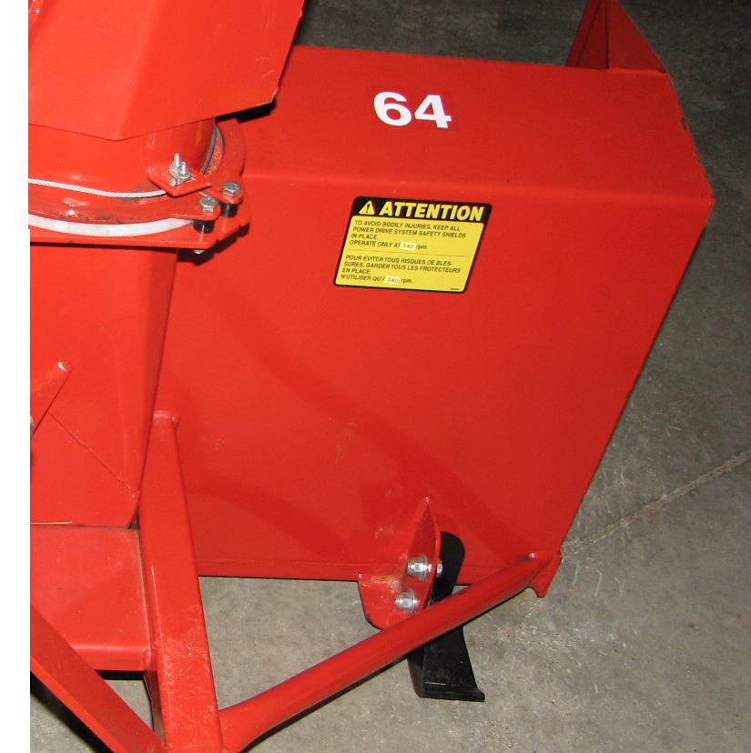

Our Buhler/Farmking 50 inch rear mount weighs 422 and is rated for 15-30 HP tractors. I think the rear mount will compliment the front plow as you will have better traction on the rear with the blower on the 3 point. As for hooking up, your 2 lift arms, your top link and plug in your PTO and you are ready to go. Ken Sweet
