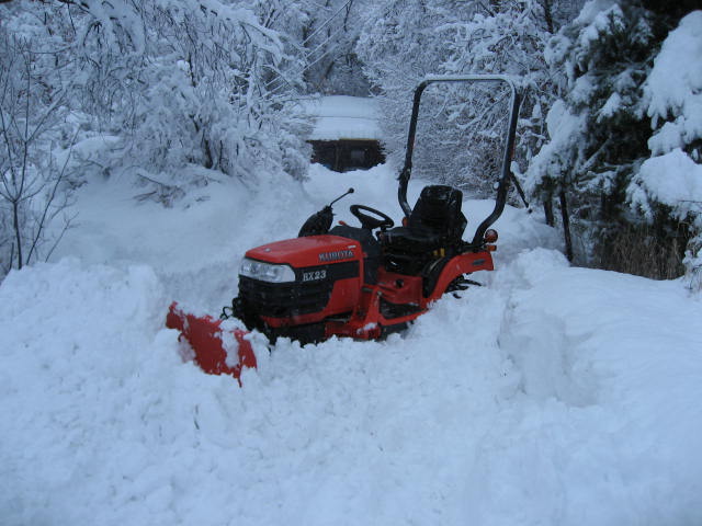

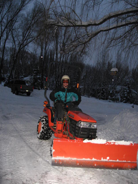

Here's me moving snow last winter. You can see the narrow area behind me where the drive crosses the ditch. You can see the plow does great, I just run out of places to put it and I have to move it so far. A couple of people suggested plowing the snow into a big pile and then blowing the pile away and that seems like it would work.

heres the pictures, since everybody loves pictures!
