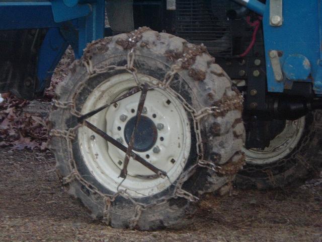

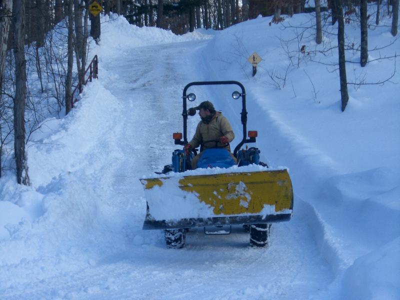

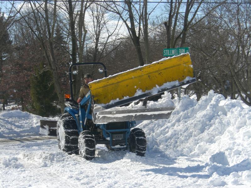

/ Winter traction..... #24
Until this year I've always used rear chains, have to look at the picture posted of the hill up to the house. But their a bear due to the weight
This year I lucked:) into a set of v-bar chains from an old Willy's jeep my father had 30 years ago, had been forgotten until the Christmas snow. So now I'm running them on all four's.
I think that:
#1 in a snowfall of less than 6" I'd just use the front because that amount of snow shouldn't put much stress on anything
#2 the ease of installation no need for the added time and back strain moving the rears. IMO.
This year in the Mid Atlantic is one for the record books and I will probably never see this much snow at once the rest of my life, I hope.
