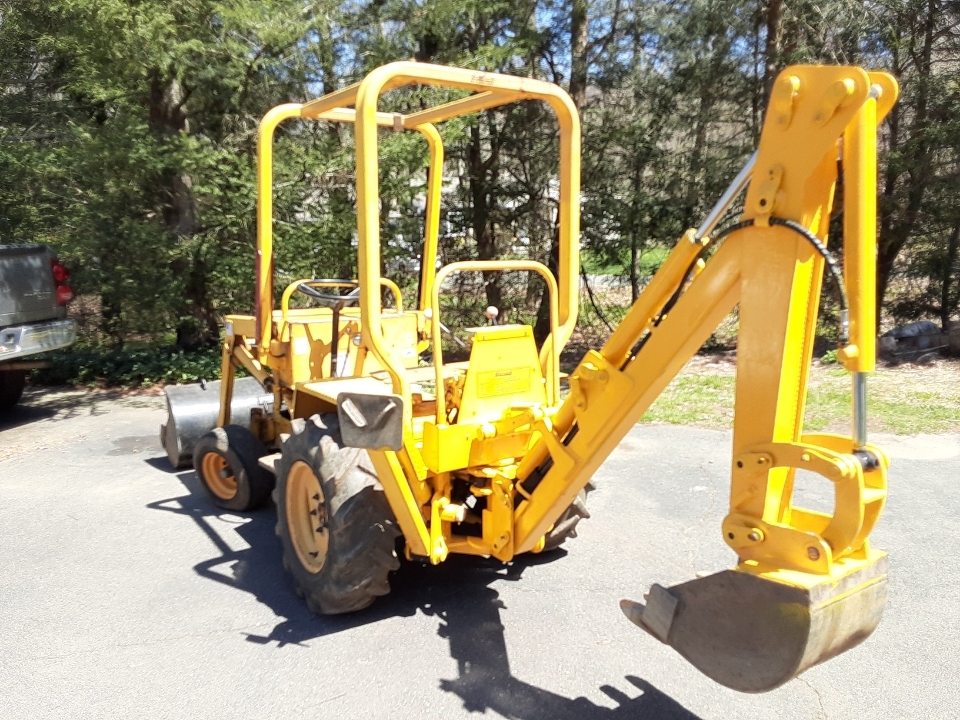

Winter's work on T5C
/ Winter's work on T5C #1
Alan7s
Aug 21, 2013
106
Sharon, CT
Terramite T5C
Rebuilt hoe and outriggers; replaced worn pins; repair & weld broken stuff.
Fixed the leaks in hoses etc. Probably my imagination but it seems to work
better. Other sections wait for another year.
#2
Sorry; forgot to add my question. The metal plate above the hoe control
says "up" or "down" for the outriggers. The way I bought it, "down" meant
the strut would go down so the machine would go up. In the rebuild, I followed the manual where it's opposite. Now, "down" lifts the strut so the machine goes down. Was it wrong before or have I got it wrong now or does it matter? Thanks
/ Winter's work on T5C #3
You have it corrected now.
