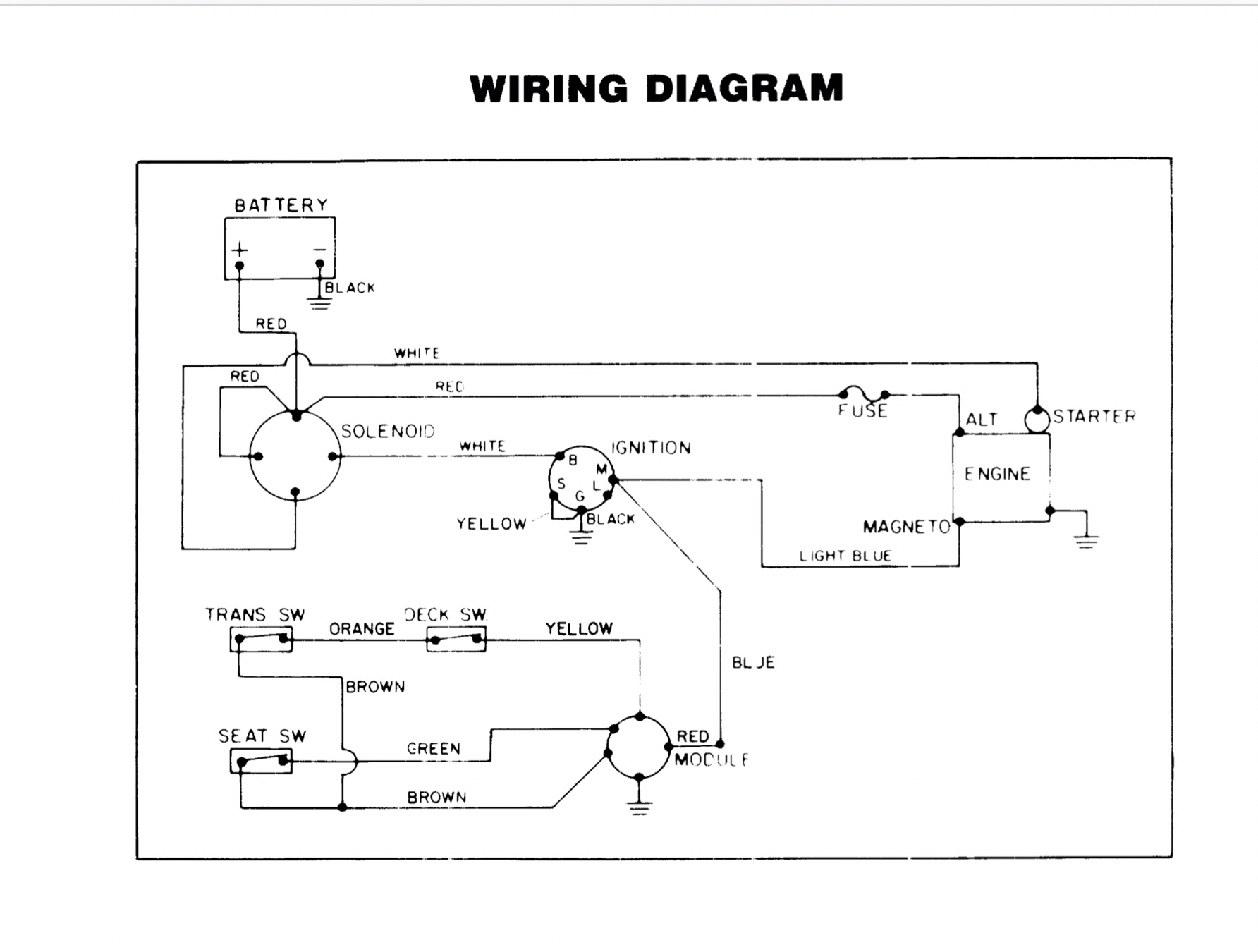

Hi,
I'm working on an 'older' Toro (not exactly sure how old - looks like the one Forest Gump mowed with :)) 8-32 "Professional" and can't get the machine to spark. Model # 56150 and serial number 9000001 - 9999999.

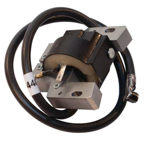

At first, I thought it was simply the ignition coil (or magneto) so I got a new one. Still no signal being sent to spark plug. I have followed the instructions of having the mower deck disengaged, the key turned "on" and the parking brake "on", pull the recoil starter and ...no spark.
Then found the switch that is engaged when the mower deck is disengaged is broken, I jumped it --- so that shouldn't be the issue.
Then found the switch on the transmission that ...must be telling the machine when it's in Neutral, and did a continuity test both in neutral and not and each time the switch was open. So I jumped (closed) that one.
Still no spark.
Looking at wiring harness. Disconnected harness at back of starter/key switch and it's a rusty mess. Going to buy new one now. Going to clean all connector-ends of wiring harness and put on the new starter/key switch.
What's interesting is that the starter/key switch, with me sitting in the seat, engages the Starter. Still no spark.
Thinking that Something in the wiring assembly is open or closed and telling the ignition coil NOT to send ...current to spark plug. Can anyone help? Even a wiring diagram?

Ultra strange - I see it now ...on my phone 🤪. Thank you. I値l start trying to map the schematic to what I知 experiencing with the machine.
Just weird that nothing I try works. Even Disconnecting the 徒ill wire from the coil.
This is a confusing one. Thanks again.

Brand new coil/magneto(?)/stator(?) and ...having done dozens of these, I believe I gapped it correctly. I let it slam up against the magnets and then backed em off just enough to allow flywheel to spin past without impingement.

The only thing I can think of at this point is that the new magneto/coil that you bought is no good. Can you remove one from a running engine and try that?
If you remove the kill wire from the coil you've removed anything that can keep the engine from sparking so then the new coil should work.
I don't think I have a spare coil laying around or I'd take a picture and post it.
