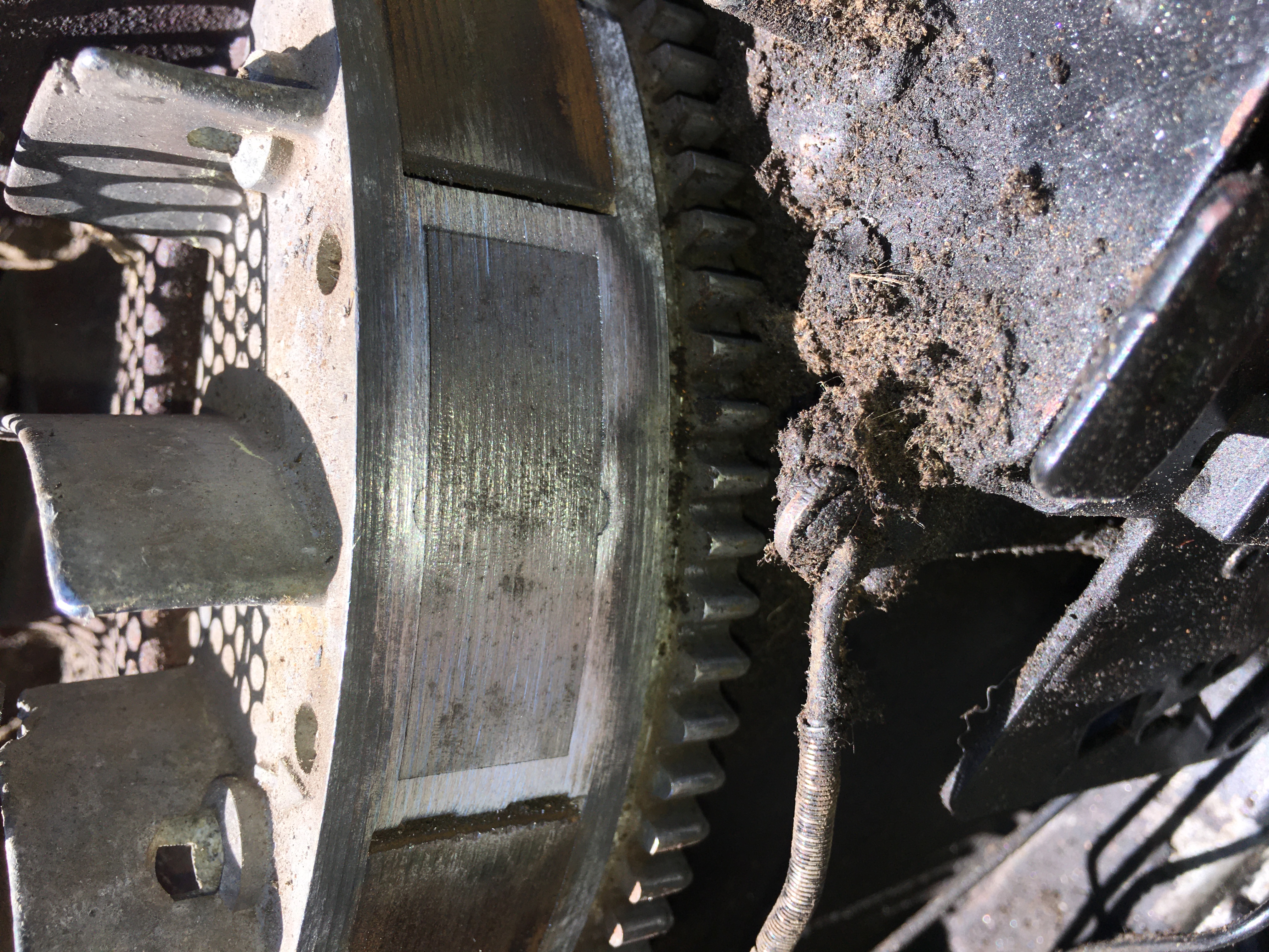

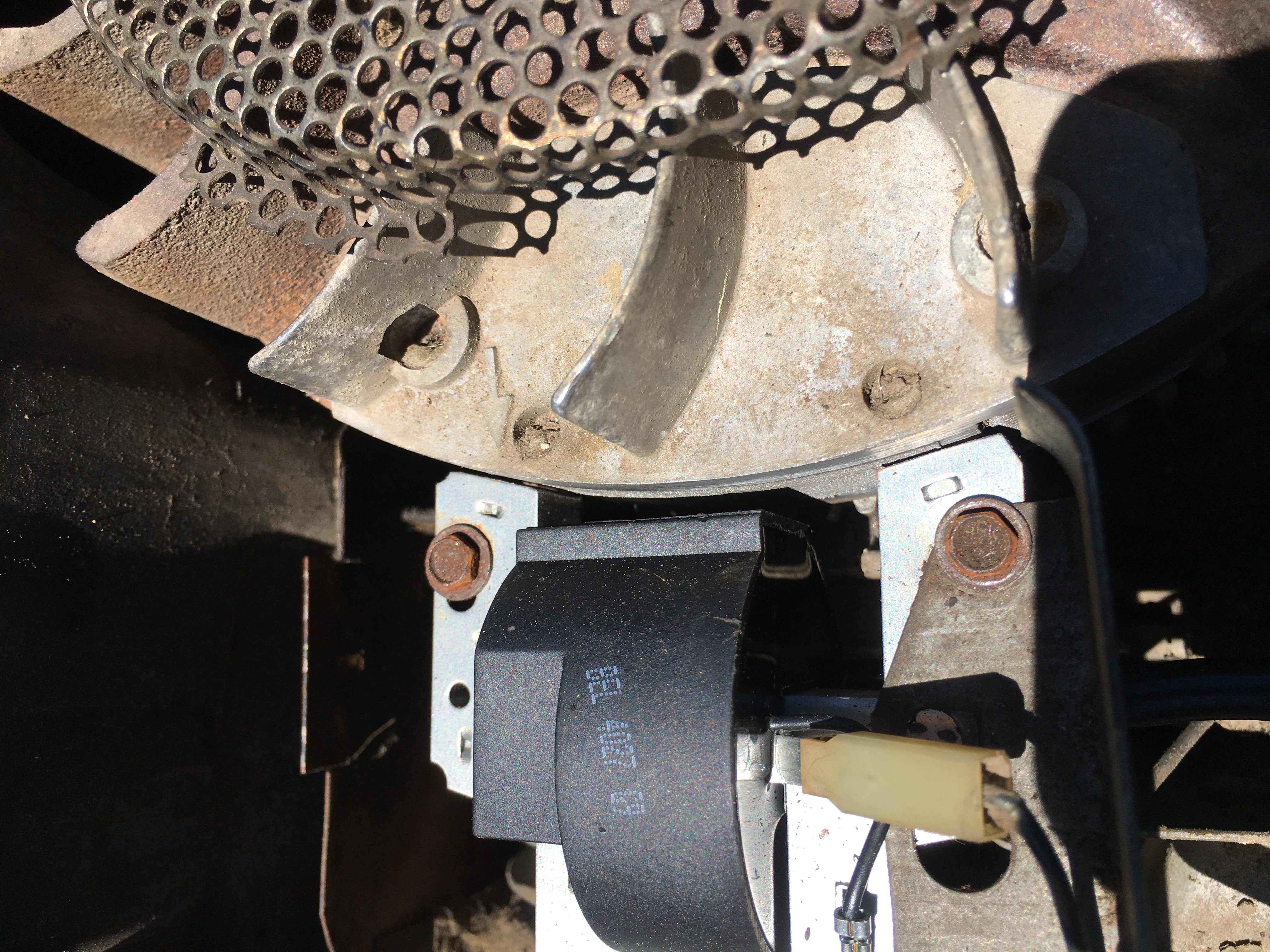

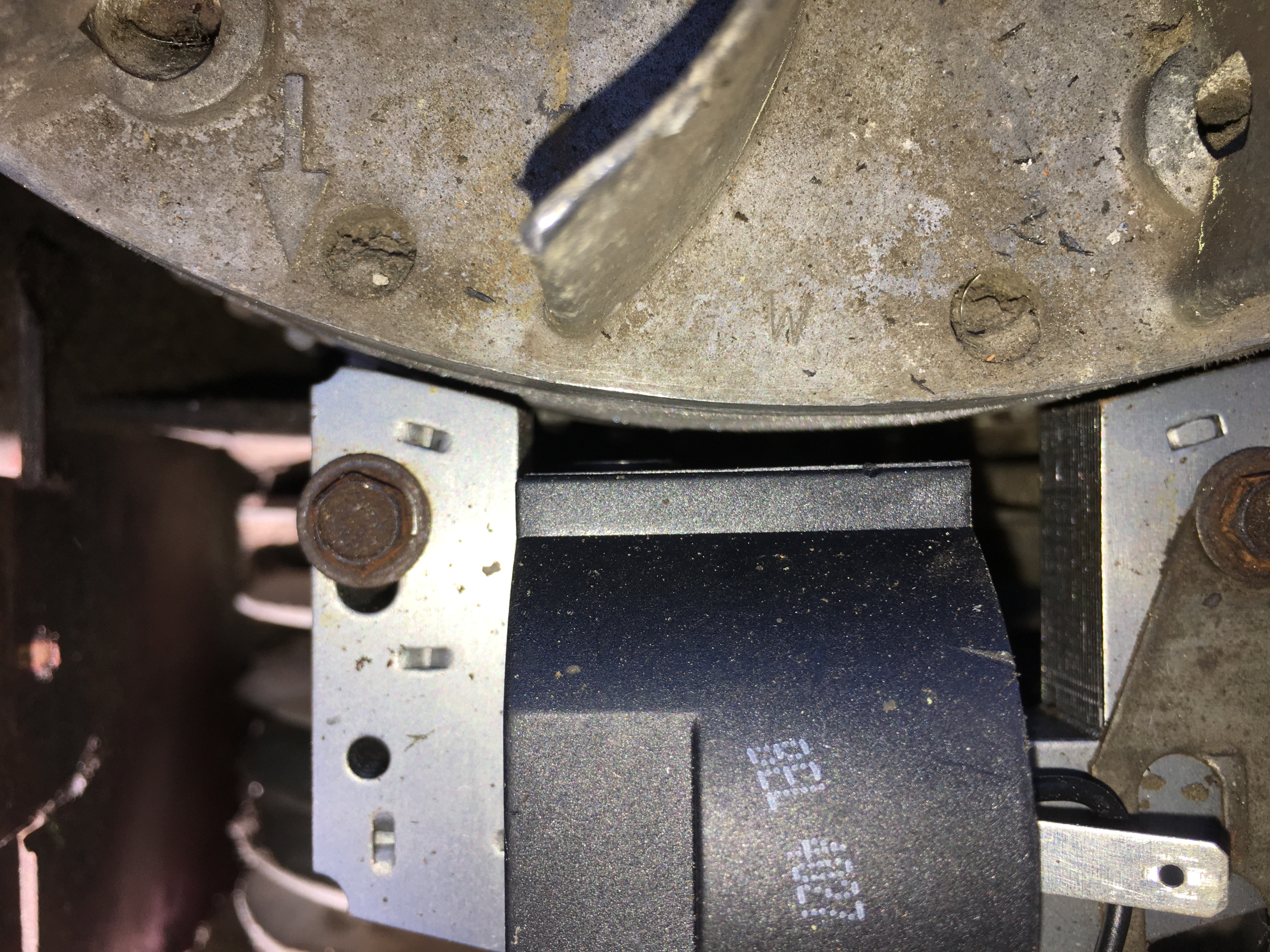

Maybe I'll upload some more pics (1st pic is after tightening up gap, 2nd was original gap, 3rd is cleaned magnet face of rotor). Thanks so much.
Jay
Got a wire brush drill bit and scrubbed the magnet surface on the rotor til shiny clean. (Wasn't really dirty before). Took picture of coil and the gap, maybe 1/16", and tightened it to ...half that. Still no spark.
What the heck?
Confirmed the test light works on other small engine. Did the 'pull plug out put in ignition wire and hold to block while trying to start'... nothing.
What the heck?
And, I just grabbed my ohm-meter and tested the old coil and there's no continuity from end of ignition wire where it plugs onto spark plug and body of coil where it bolts to engine. Same test on new coil and it's around 2.30 resistance, which I"m told is proper....

Your pictures all look good to me. It's the way I would do it. There is supposed to be a certain gap which I don't remember. I've always assumed that the closer the gap made for a stronger spark.
If the flywheel had broken the key and slipped on the crankshaft you should still get a spark. Just not at the right time. Are you brave enough to hold onto the coil wire, spin the engine over and see if there is any tickle there at all? I used to test out in the field by holding a piece of grass about two inches from the spark plug and pulling the rope. If I got a light tickle the spark was good. Your mileage may vary on that idea. I have very dry skin and can hold a live 120 volt wire without feeling anything.

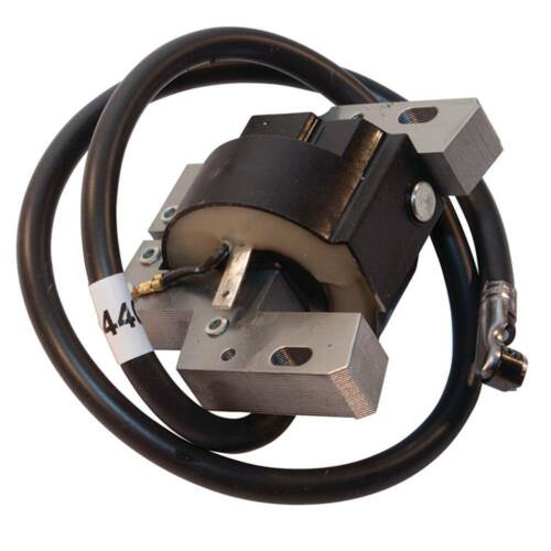

Here's some info from B&S. Maybe this will help. There is a link to testing coils on this page.
How do I repair ignition problems? | Briggs & Stratton
This is a picture of a B&S coil. Probably not the right one but I just wanted to point out that the round silver "button" between the two legs of the coil is the trigger for the spark. I believe all new coils come like this. The older coils don't have it but can be converted to electronic.
Thanks so much for you help here! I may try the "tickle" test, but, I"m 99% there ain't nuthin coming out of the spark plug other than my sadness.
That coil is identical to the one I removed, and replaced. Button and kill switch connector. I know my old one was dead as there was no continuity from ignition wire tip to coil body, whereas the new has infinite. But still no spark. I'll check that link and see what I learn.

OH MY GAHHHHHD. I'M AN IDIOT.
I had the coil on UPSIDE DOWN!!!! Running find now. Very sorry my stupidity wasted y'alls time. Thank you kindly for the guidance.

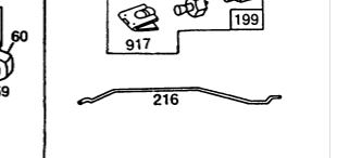

This could be another one of those "we all have moments we aren't proud of", but, after getting things running pretty well, mowing, etc. I thought that the machine would run better with a carb cleaning. So, I took pictures of everything prior to removal, then took off carb, cleaned, and now reinstalling ...and the throttle linkage popped off wherever it was anchored ---- AND I CAN'T FIND WHAT THAT ANCHOR IS?
What an arse! Can anyone shed light on where that butt end of the throttle linkage goes? It's somehow sitting (hiding) behind the choke/throttle arm adjustment mechanism --- conveniently out of sight on every picture I took.
   / Wiring diagram for a Toro 8-32 Professional riding mower
#20

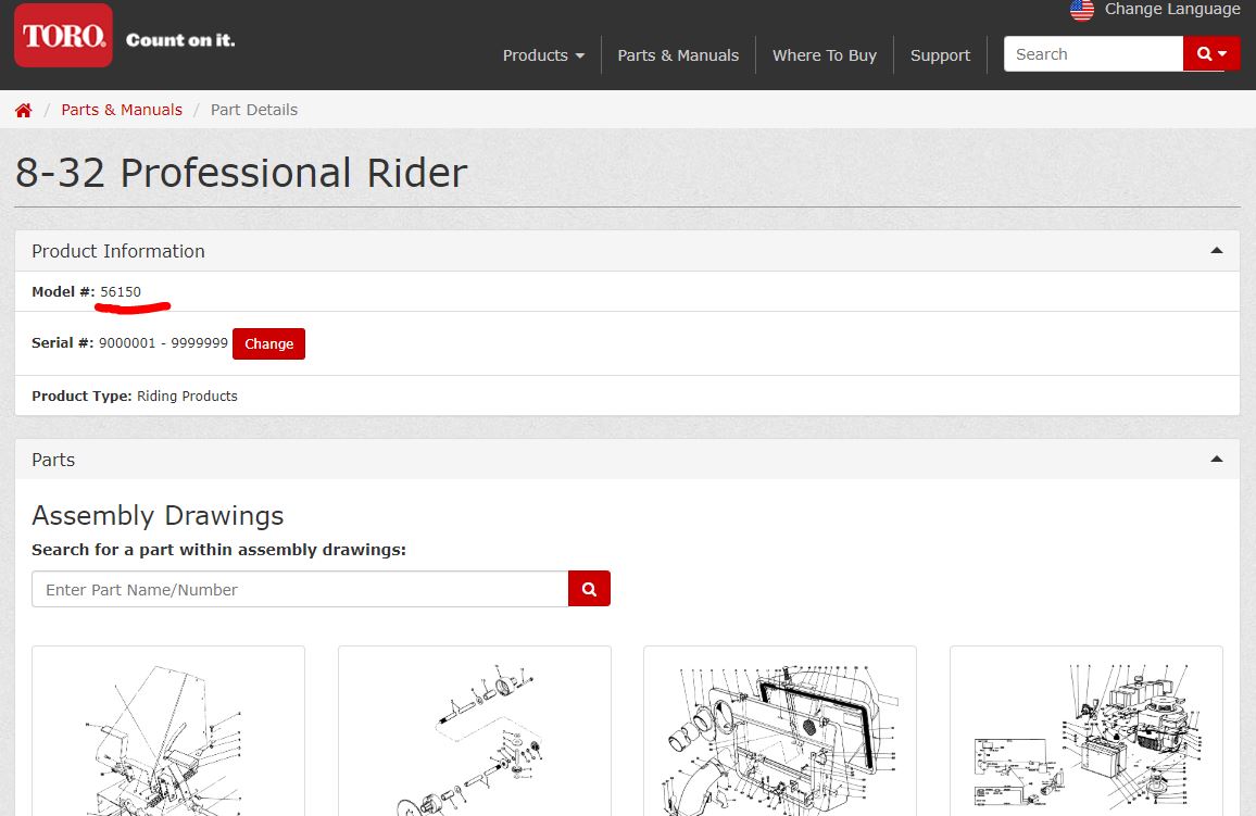

The parts drawings should show it:
Unfortunately, I don't believe it does show it. Or if it does, just like the choke lever connector (attached), it doesn't show where it connects...
