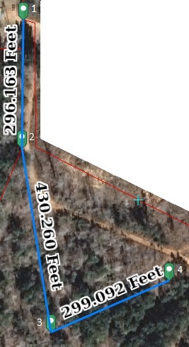

I'm interested in building a house and shop on some land. I have not contacted the power company yet as I wanted to get some advice on how to route the power into my property and if I have any options available to me. The entrance to my property is funnel shaped with about a 300' road leading into the gate. On my attachment, point 1 is where the end of the county road meets my private road, point 2 is where my private road leads into my property, point 3 is where my shop will be located and point 4 is where my house will be located. The distance between point 2 and point 4 is approximately 470 feet if the wire would be cheaper going that way first. My question is does it matter if I take power to the shop and then to the house, or do you have to go to the house first and then to the shop? The house will be around 1600 sq ft and no unique power needs. We'll have I guess "standard" HVAC, stove, water heater, dryer and well pump connections, so I guess 200A would do it. The shop won't be anything really unique either. It'll be about 1300 sq ft and I'll be running only 1 power tool at a time like a table saw or planer, or maybe 2 at a time like a dust collector while the tool is running. I would like to be able to run a 240v welder, but just a "standard" buzz box stick welder. It'll be just pretty much a "hobby grade" shop, not a commercial enterprise, so maybe a 100A deal? Maybe 40-60A would do it, I don't know. I *will* feed some stuff out to outdoor outlets, lights, etc for animals, coops, pens or whatever, but that probably won't be much of a draw. I'm a "one man show" so the odds of running anything much simultaneously that would overload the system is very doubtful. Ideally, I'd like to put a little utility building just inside my gate and then trench everything myself as I have time so I don't lose any more trees than I have to. If the power company brings the line in overhead, I think it's a 15-30' wide lane they have to have and I'd rather not cut that many trees down if I can help it. However, depending on how much they're willing to run for free versus what I have to pay for, that may sway that decision. :) If anyone can look at my map and at the power company sheet and tell me what I'm looking at, I'd appreciate it. I'll answer any questions I can. I'm not planning on doing this work myself, I'll be hiring an electrician, I just wanted to educate myself as much as possible before approaching the power company. The older I get (translation, the grumpier LOL) the less I'm willing to take what a single employee of any company tells me as "the gospel". I'm certainly not going to argue with a rep from the utility company, I'd just like to be able to bounce ideas off them if they only see "one way to skin a cat" if you will. Thank you.
It doesnt matter where you get 200 AMP service from the local utility (at least 200A is the common drop here in CO). Bring it into the garage, then run underground condiut to the house. Garage is main service panel, house is just a subpanel (even if it has more circuits...doesnt matter).
What I would do is get 200A dropped at a boundary line on your property. Then trench from there to where you want it. If the garage is closest, trench there. Then trench from garage to house site once that is needed. In CO the utility company must run it up to your property. From there you can get a licensed electrician to run it to your house. If you do the trenching it is usually much shallower (in CO 18 inches if owner does it, 3 ft if utility company does it). You trench, get the proper conduit and gauge wire (electrician can tell you based on the run) then cover it up. Consider adding a second conduit line if the electrician recommends. Sorry from that rate sheet I cant tell what it would cost if you trench. It looks like you still have to buy the conduit from APCO at $3.14 per foot which is a racket. If that is the case you can figure it out. It doesnt mention the wire to be used either.
After careful consideration we are going off grid anyway, so none of the utility company stuff really mattered.
