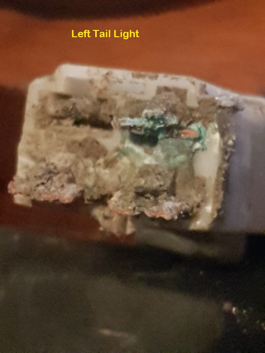

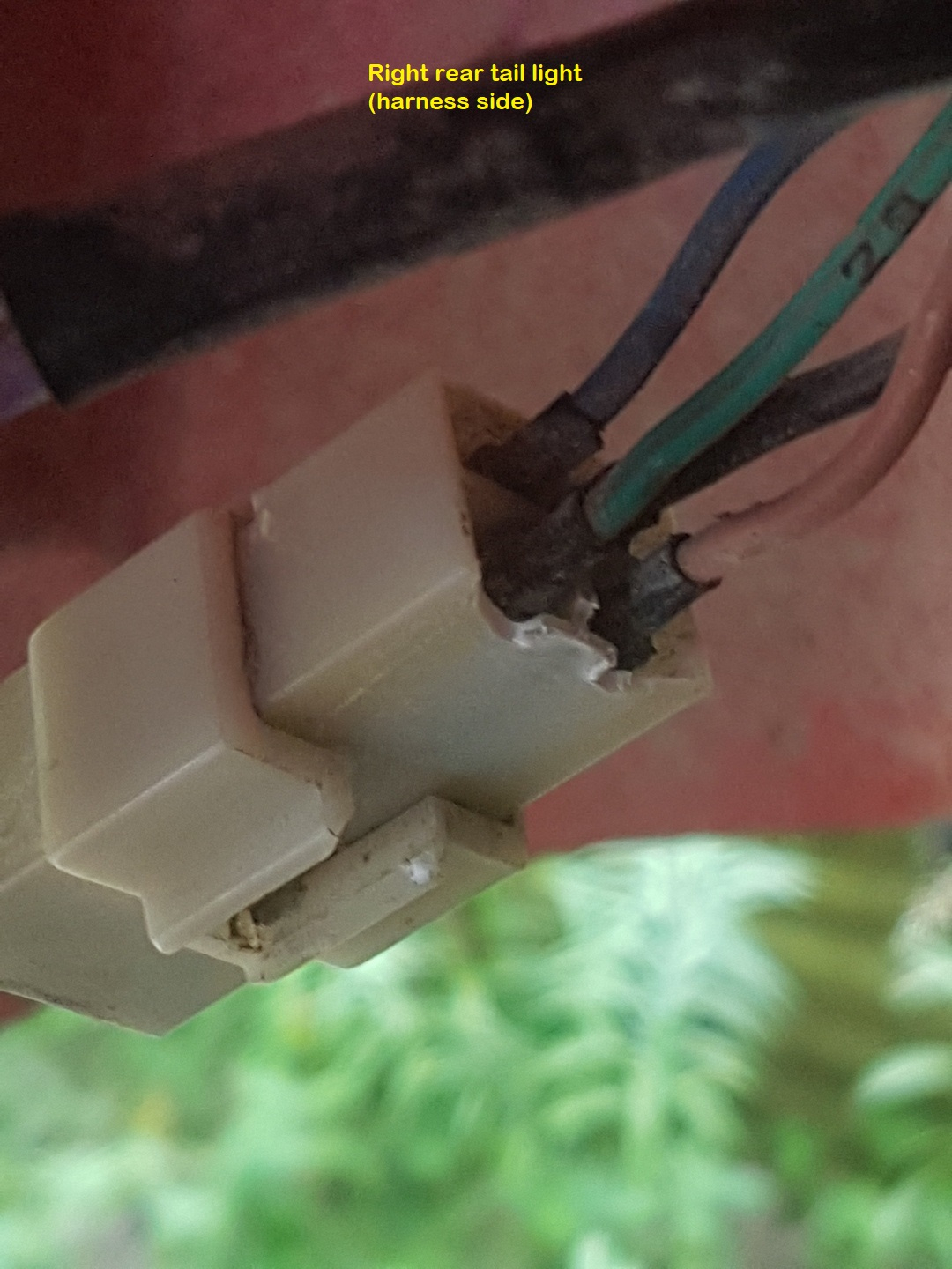

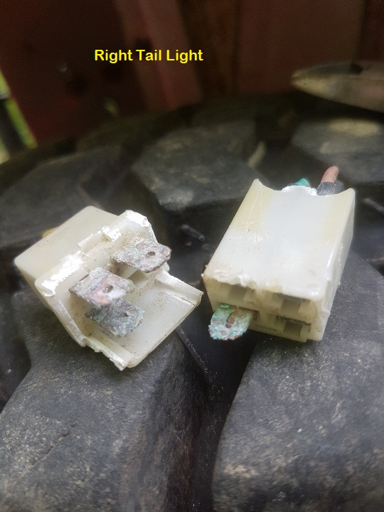

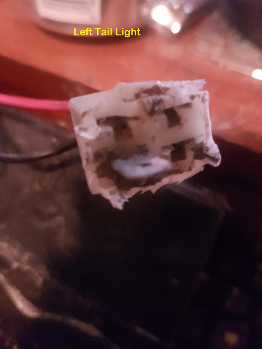

/ Wiring Problem(s)
Thanks Piper
I had 10 minutes this morning after work and did another visual.
Found the left side tail light plug wouldn't come apart and a wire broke off at the touch of it.
Cut the connector out and had to destroy it to get it apart.
No surprise, it was a ball of corrosion.
Next step is to refresh any connectors I can't get apart, either by soldering wire direct, or replacement connectors (preferred).
I'll check the backflow problem on the way to find new connectors. Hopefully the second corroded connector is the cause.
Either way I'm making progress of a sort.
(Piper, hope you're keeping tabs on this thread. You've been helpful so far and I figure I'll likely need more advice on this).

/ Wiring Problem(s) #8
That is some ugly stuff right there...
Go to your friendly local automotive parts store and pick a style of connector you like. Weatherproof preferred but may not be an option. In any case di-electric grease is your friend on re-assembly. Also either Bo-shield (sp?) or ACF-50 are great products. I use ACF-50 because that is what is available. I put a few drops on the open end of every wire I can get too every year or so. It soaks in by capillary action and claims to stop corrosion from getting worse and to stop it from starting in the first place.
If you must splice onto a wire to replace damaged sections or to increase the length I recommend crimp on butt splice connectors that have the heat shrink built in. It has an internal layer that really helps to seal the wire insulation to the connector. They are more expensive but in this application, well worth the price.
Keep in mind that the factory wire may not actually be the size it is supposed to be. When trying to connect to "real" wire you may find that the factory stuff will not crimp tightly in the connector. When this happens a little trick I use is to strip twice as much insulation as needed and fold the exposed wire in half to bulk up the volume in the connector. Try to physically strain relief the connector so that the wires are not vibration stressed in or at the edge of the connector. Sometimes impossible to do, but when you can, you will reap the rewards in fewer future breaks.
Good luck and keep us posted.
I get automatic announcements when new posts are made to this thread.
