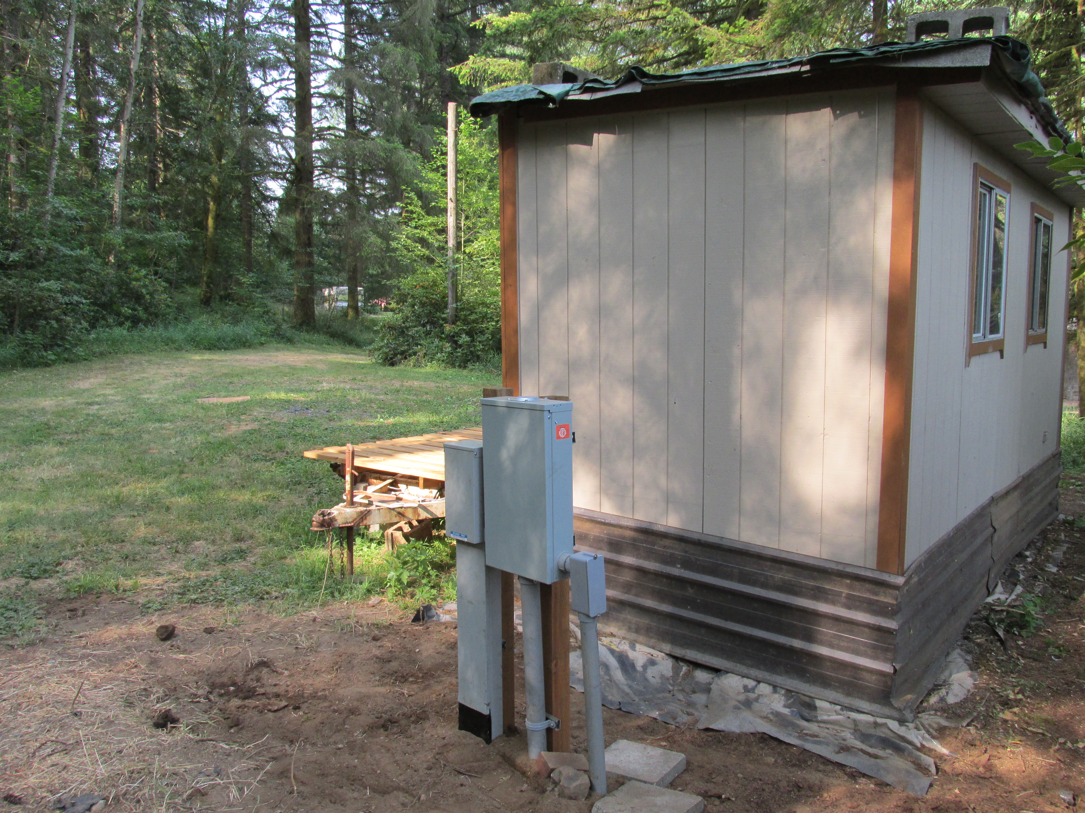

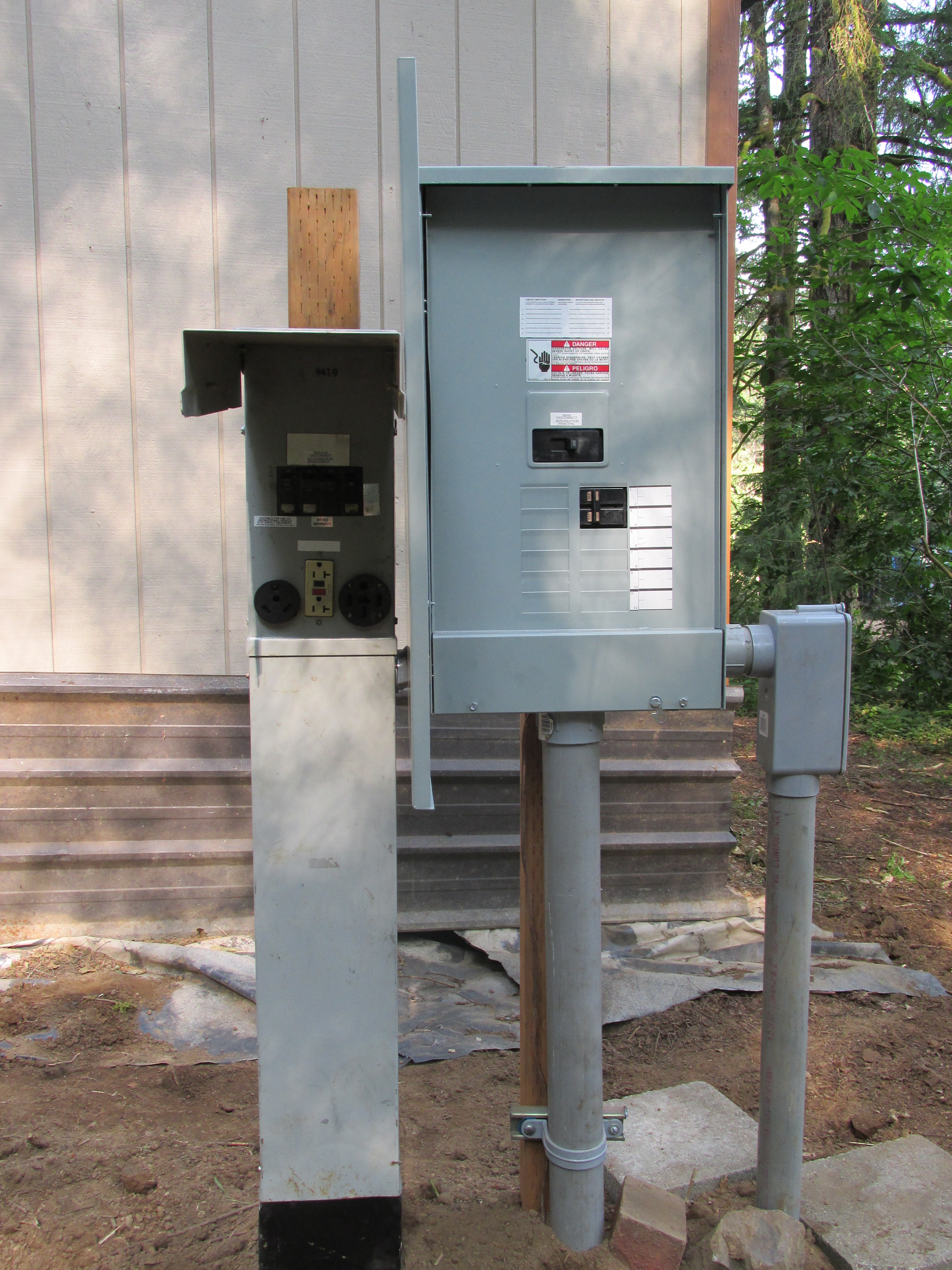

Woodland im just up the road from you in Amboy and yes you probably need a 200amp for future branch circuits.
the SWW dol inspector made me install this monster box for a simple 50 amp rv 20/30/50 pole. it has a 4-4-2 feed and transformer just 100 feet away.
I used a milbank 200amp 6 space box. nema exterior rated box- 2- 4x4 poles- the rv box... and tied it all down with home depot strut.
I told the inspector this monstrosity was a bit overkill for a single harborfeight trickle charger outdraw and one t-8 light. he said (well).......LOL
the transformers are great for surge (motor start-ups) but SWW is going to want massive overkill on everything. IMG_1027.JPGIMG_1032.JPG
