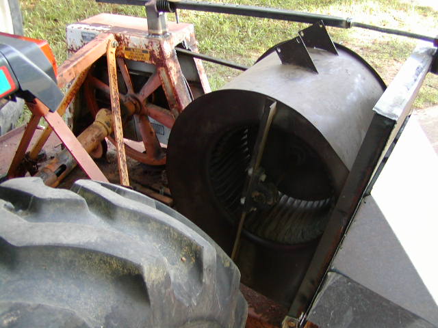

Neal, very creative as usual. So the mower deck serves no purpose other than a platform for your blower?
Spence
   / Wishing for an AFFORDABLE PTO leaf blower #14
That is correct Spence,
The deck is just a frame to hold it all together.
Here is a pic of front view that shows the drive pulley on the rear of the pto shaft. I took one of the blade pulleys to use on the blower wheel. I did have to drill out the hub for the larger shaft. Was even able to make an old belt fit. Had to buy practically nothing.
