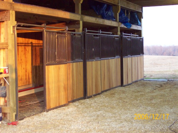

The metal stall fronts are from Priefert but I had the red oak milled locally.
I did the welding on the grill dividers between the stalls & will start working on the swinging dividers for a mare/foal stall when the weather gets lousy.
Here's a photo looking down the hall of the barn. You can see more of the stall fronts.

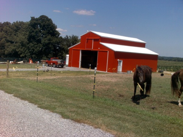

Exceptional Horse Barn, Great work. Believe me I know how much hard work went into this barn.
Would you happen to know if this style of Barn is called "Monitor Barn" ??
   / WKY Horse Barn
#96
Dull - thanks - I have a new appreciation for barns after bulding ours!
"Monitor" is the name I've heard although I did not know it @ the time we picked the design. We just wanted a barn that did not look like a garage/machine shop & neither of us like the gambrel (sp?) roof style.

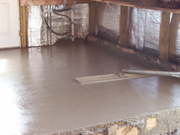

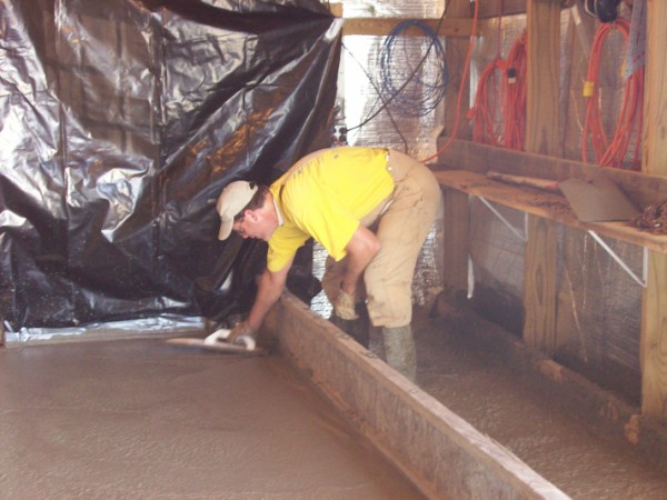

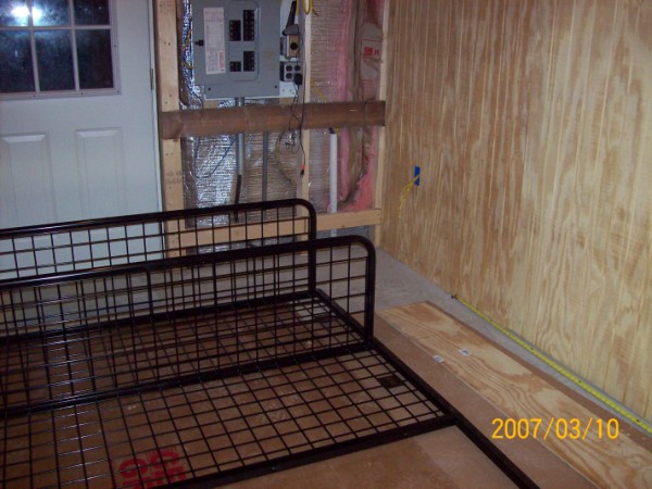

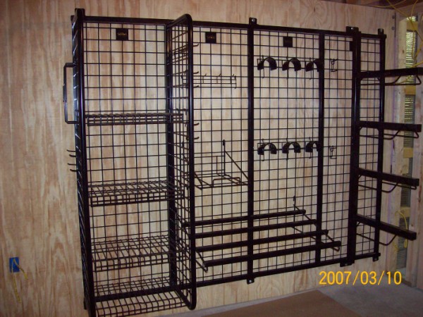

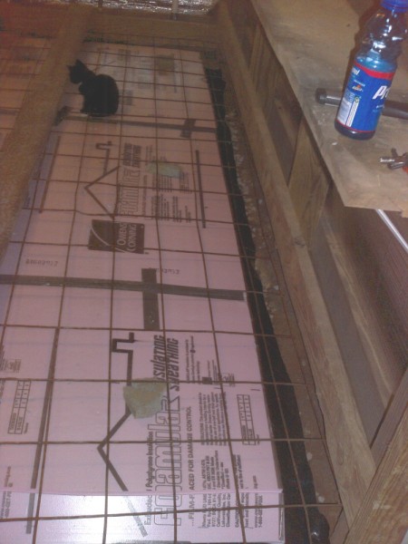

With the outside finished some inside work progressed this year. We got the concrete floor in the tack room poured, framed & batt insulated the walls, finished the TR walls & installed the manufactured tack rack.
For the 4" conc floor we placed, leveled & packed about 8" of crushed limestone then 6mil poly vapor barrier followed by 1" insulation (taped all seams) & WW mesh on conc bricks (keeps it in the middle of the slab). #4/s were tied to dowels driven around the perimeter to give the haunch some strength. My grade control was pretty good as I came out w/only 6CF extra (which ended up as a concrete head wall for my road culvert).
The tack rack is premanufactured by Dry creek tack Horse tack, equine tack storage, horse saddle racks, horse tack rack, garden tool organizer
& is a super system w/tons of flexability in positioning tack whereever you'd like & then changing your mind later.
Here's some photos of the conc & tack rack when new.

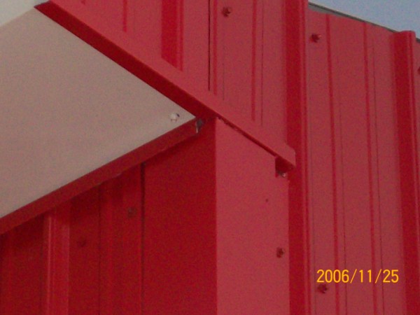

One of the areas of trim I had the greatest difficulty figuring out was where my corners came up to meet the soffit on the back & front of the building W/our barn style there were 8 of these locations so I wanted a simple but watertight way to affect this.
I ended up w/a detail that looked like the attached - the top of the corner trim is notched & folded back to the building & the "J" trim on top slips into a notch cut into the siding. a fair amount of caluking was applied behind the J & between the J & top of the corner flashing to seal this. So far no leaks.
