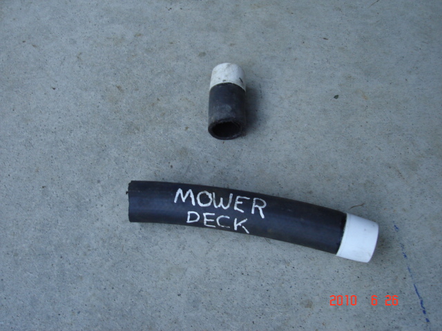

Scott, you can make up covers for the PTO shafts by using appropriate lengths of 1" heater hose. When I made mine, I glued a spray can (window cleaner) cap on one end. Slips on, stays put, works great.

Irvingj, so your cover fits tight on the PTO and spins with it? Are your reasons for having it to keep the shafts clean and prevent chipping of the metal from objects on the ground?

Scott, absolutely. I too saw in the owner's manual about mid PTO cover and asked... nobody knew anything about it, or so it seemed. We even looked at another new 2310 on the lot and saw that it didn't have a cover for the mid PTO, either.
I do have the factory one on the rear which is held in with a bolt, which I've left on, since I --currently, at least-- have no 3PH implements.
The short one goes over the mid-PTO when I'm using the FEL/BH combination. I also made a couple for the MMM, snow blower & quick-hitch assembly shafts while they're in storage.
Yes, the mid-PTO cover stays on just fine, though I'll admit I haven't tried it while running the PTO... no need to.
I wasn't sure there even was such a thing as 1" heater hose, but there is. It fits fairly snugly, and keeps the shaft grease clean and in place nicely. I figured at the very least it would keep dirt & debris off the shaft splines, and it has worked well in that regard. I bought about 3' of it from an auto parts store for about $3, I think.:thumbsup:
