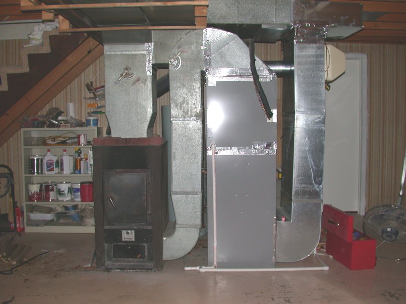

   / Wood Burning Add On Furnance (Price of Wood) #39
Your post said you wanted to add a second source of heat and implied that WOOD was your first choice....well...
I burn wood for heat. My system has a Monarch Add-a-Furnace tied into the warm air ducts right next to my propane furnace. My wood furnace is my primary system
and the propane furnace is backup heat. I burn about 3-4 full cords per winter.
I estimate that we save $1000 per year compared to propane costs.
But here is my point, finally.
It really depends on what kind of wood heat that you are thinking about.
For example, exactly what kind of existing heat system do you have? Are you going to completely replace the old system or just add a (hot air) furnace? Or just buy a wood stove for a cold area of the house or ??? do you just want to burn wood?
Beenthere, talked about the huge startup costs for beginning to burn wood. He's probably correct.
However, my suggestion is to tell us exactly what kind of heating system you have right now and let us suggest how to AUGMENT your existing system cost efficiently. /forums/images/graemlins/smile.gif
Burning wood is satisfying and can save money, but there are some big startup costs if you're at the very beginning of a conversion from gas to wood burning...
dwight
#40
Dwight
My primary heat is forced air propane like yours. I have two heaters, one in the attic and one in the basement. I plan to add the second furnance as the add on source. I'm thinking more coal now over wood since the storage issues of wood and the cost of wood is a big concern.
I think I'll be able to heat the basement, garage, first floor and just let hot air rise to the second floor. We have a huge open foyer that lets massive amounts of heat up the hallways.
I'm doing the research, and a coal pellet with a stoker seems like the way to go. Coal is dirt cheap around here and it can be dumped thru a basement window to a wooden hopper that I need to figure out how to build.
