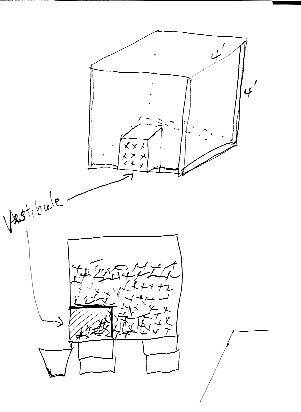

I've done both and if I did it again I would definitely choose coal over wood, especially if I lived in PA! My heater was a stand alone wood stove type (Vermot Castings Resolute), not an automatic furnace.
Regarding a coal bin. I don't have photos but I can describe how I built a simple one that worked pretty well. I'd first say that if you can, use pea size coal. It is easier to work with and start. Second point is to make sure you never have to shovel coal "up" into a bucket. Design the bin so you just rake it out into a bucket on the floor.
To build a coal bin, I used 4x4 sheets of 1/2 inch plywood, a few pieces of 2x3 lumber and a fist full of drywall screws. A 4x4x4 box holds about a ton or ton and a half as I recall. I placed the bin on a base of cinder blocks under a basement window so the coal truck could unload directly into the bin. The bin was about a foot off the ground. That is important so you can put a transport bucket on the floor and slide it underneath the edge to scoop the coal into. It took more time to go to the lumber yard than it did to put the thing together and it served me well for the several years it was in service.
The only tricky design element is providing a way to conveniently get the coal out of the bottom/side without allowing coal to flow out onto the floor. To do this I built a simple interior roofed tunnel that I cannot find the words to describe technically. (I'll send you a PM to get in touch if you'd like to hear exactly how I built it). This "tunnel" had a top and two side walls but was open at the side of the bin and about two feet inside the bin. The roof of the tunnel directs the coal immediately above the opening at the base back to the middle of the bin to keep coal from flowing out of the opening. It needs to be sized to allow coal to flow almost to the edge by gravity which meant that I could fill a bucket almost passively (I'd just reach with a shovel/rake into this little antechamber/vestibule and pull coal out into the bucket. As I pulled coal out an equal amount would, by gravity, replace what I'd removed etc. This system was pretty efficient and kept the coal from flowing out to the floor.
A "back of the envelope" drawing of the coal bin is attached.

   / Wood Burning Add On Furnance (Price of Wood) #44
Well, it seems that since you have a good supply of coal readily available to you, coal is a better choice than wood and way better than corn (esp due to availability).
