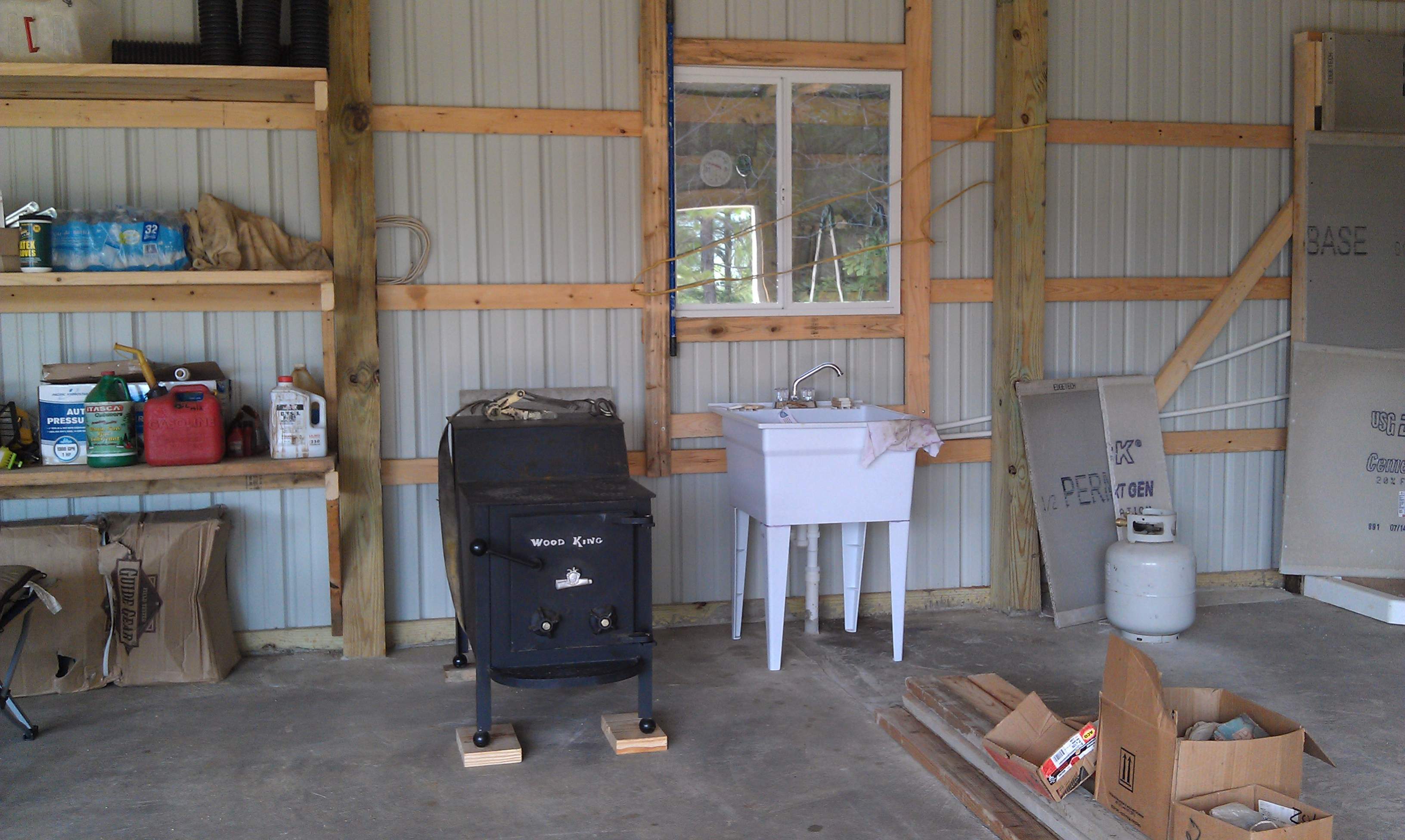

Would someone please suggest a way to insulate the wood behind the stove...
See previous post. Thanks
Buy some backerboard...it's like a cement board for cementing tile to walls and floors. You can put your hand on the back and it doesn't get warm. It's 1/4" thick. I have it behind my stove in the house on a paneled wall. It's been there 13yrs now.:thumbsup:

Thanks for the suggestions guys...
I bought some cement board to back the shower walls and propped it behind the stove since it has not been used yet. It's VERY heavy and because of that it would not be easy to attach to the studs going up 10'. I like the thinner "backerboard" idea because it has to be lighter.
Now I must admit....what is backerboard? Is it masonite that you put under vinyl or tile floors? and semi fireproof? I guess I could glue tile over it....?
I have to remind myself that this is a shop and not a home.....:eek:
