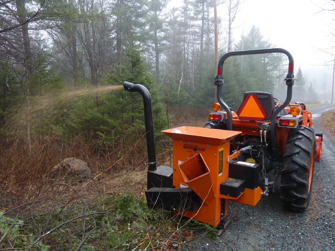

I have a BearCat 554 5" chipper on my 30 hp L3010 that goes real well. I also have a mile long drive/road to maintain and lots of woods roads so I know how long a mile is :D.
I'm not sure what you mean by widen a woods road ( how about a picture )but if it is what I think it means like on my woods roads then I think you should consider getting everything cut and piled along the road. Make your piles perpendicular to the road with the butts out. Then go and rent a big chipper with hydraulic feed like a tree service would use and start chipping your way down the road. A few hard working friends would be a plus. You will get it done far easier, faster, and cheaper.
It sounds like it might be a very big job for a BX42 size unit if you plan to chip much stuff in the 4" range and the woods are thick.

Gordon, the main road I could tow in a chipper (although very rough going at this point). The cleraring is mostly smaller stuff to widen the road and use the tractor to level out some and then the chipper. I guess I could do that and leave the smaller woods roads alone and just pile up neatly for habitat. For me to rent for the day would be about $300 and this could go on for a while, hence the thought of the 3 pt. going up to the farm again this week to continue with the saw and look at the situation again.

Raider - the only reason I suggested you think about the big rental unit was because I thought you might be in a hurry. If you have time it is a whole different ball game.
I chip stuff on the main road to make it look nice but I hardly ever chip stuff on my woods roads. I either make brush piles or just let it lay and cut it enough so it lies close to the ground. Hardwood rots quick and gets covered with leaves so it disappears quick. Softwood takes a while. Most people now seem to want their woods to be more more neat and sterile looking and opt for chipping or removing all the slash. A more messy woods with lots of large and small woody debris laying around is what wildlife prefer. It serves plants and animals all up and down the food chain as it slowly decays.
