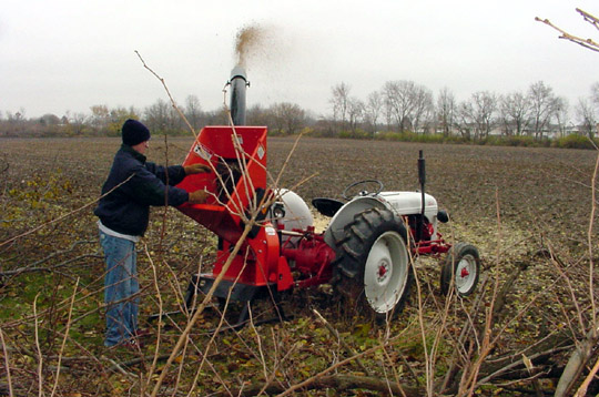

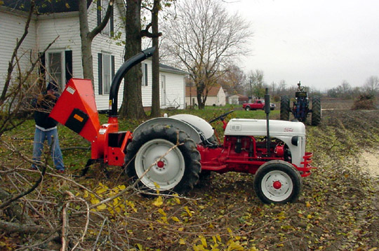

This BearCat has served me well over the years. Quality built and no problems. Only feature I would add is automatic feed, but that comes at extra cost. Philip.
