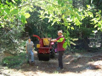

I went with the 3pt variety for two main reasons:
didn't want another engine to maintain
can get a much better built 3pt model for similar money as a not very good stand alone.
I figure anything bigger than about 2.5 inch wood is firewood but the chipper doesn't even twitch when fed the smaller stuff. Mine is rated 4' so I had to try it. Turned a 4" at the butt and about 30 foot long tree into chips in a very few seconds.:cool:

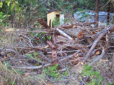

I've rented one the few times I've needed something large. The thing I rented was bigger than my tractor, chewed up logs. I've started keeping all that wood instead of chipping it. I pile it in back along the pasture fence to make shelter for wildlife, and rotten wood produces all kinds of things that birds like to eat. Also keeps the horses from pushing down the fences, don't have to trim under them, no pollution, save the whales, etc.
