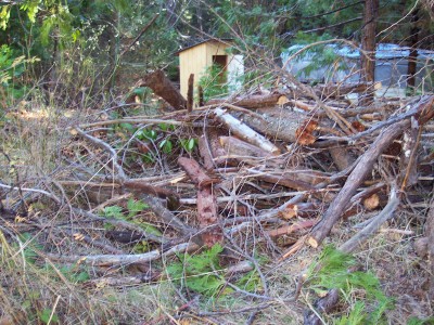

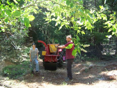

I've got 8 acres of left over logging debris and have been using a WC4 that cost $1350. It works well, has about 10 hours so far. My 2301 uses less than 1 gal per hour of fuel at 2100 RPM. I have chipped 4" trees (big end) 15 feet long with no problem.
