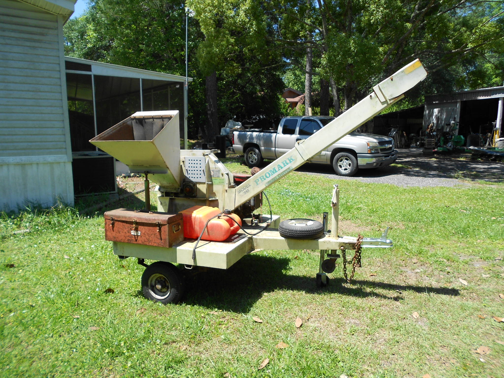

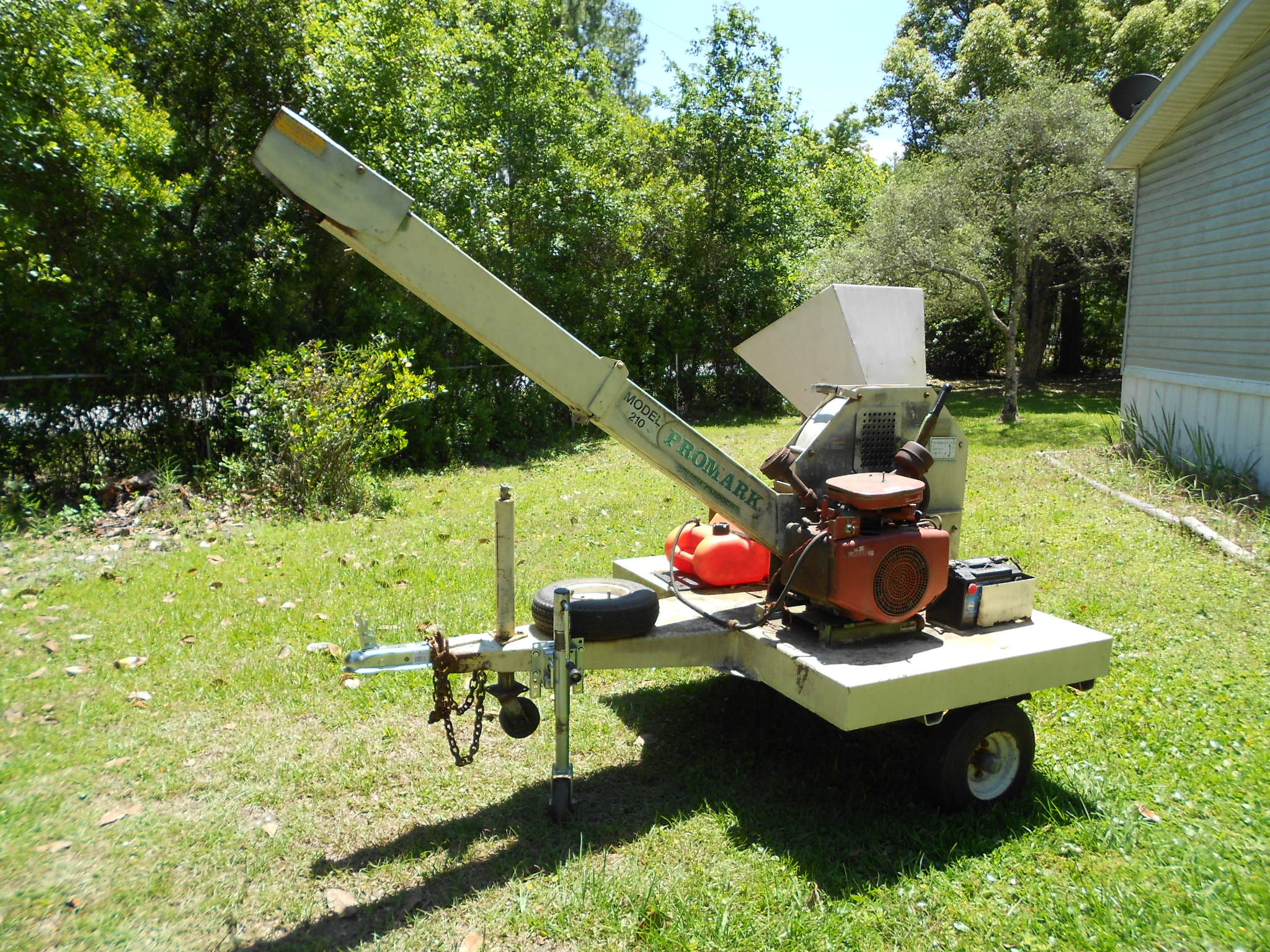

With chippers you want the biggest rated you can afford.
If you were only chipping the the main trunk it would not matter but it's when the side branches get to the opening and then stop the feed.
I had a couple of 12" chippers with 4 cylinder Ford engines that I got in a deal.
The weak link was the (172 cuin) Ford engines, they have habit of overheating and ruining the $600. head. I sold them.
I had the 8" in pic and it worked great BUT the branch issue. I sold it too.
The flywheel does all the work so everything else just supports it.
