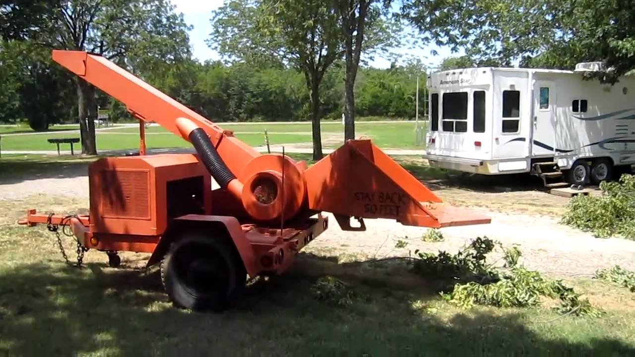

We bought a used tree company chipper through a Craigslist ad several years ago. Paid about $1500 for it and the 4 cylinder Ford engine sucked a quart of oil every hour of use but it worked well. A couple years ago we replaced the engine with a salvage yard one, same engine as a 1985 Ford Mustang 4 cylinder (salvage engine with about 80k miles cost us $500). It pushes about 80 HP and chips just about anything we can feed it.
The chipper itself is an Asplundh Chipmunk chipper. This is a Chuck-N-Duck chipper....you throw the brush into the chipper head and get the heck out of the way. The chipper head IS the infeed device. It will suck in a 4" diameter 25' long oak or maple sapling in about 8 seconds or less.
I don't have a picture of ours handy but this pic is very similar:
