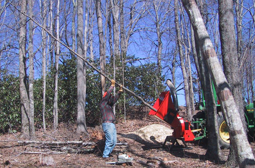

We have a Wallenstein. Burn permits are a bit of a pain here so we chip all the tops and saplings.
The dealer suggested the ext size up so that I could fit bigger pieces. Wish I'd listened to him as we often have to cut off the base.
That said, in 45 minutes we turned a brush pile 20' long, 10' wide and up to 6' high into a pile of chips. When I'm clearing trails we just feed the stuff right into the woods. Works great.

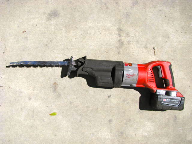

Weight of rotor, number of knives and size of opening to knives key. Wallenstein's chippers have heavy rotors, four knives, rectangular opening. Competitors mostly have one or two knives.
Chippers do only somewhat trimmed tree trunks. Small branches, especially green, and leaves will clog a chipper. Wallenstein makes this pretty clear on their web site. Best tool to clear clogs is a battery powered Sawzall with a 9" blade, which "saws" clogs out immediately.

I have a Woods 5000 chipper/shredder which I've owned for about 7 or 8 years.
If the OP is a typical residential user (like I am), I think he'll find the shredder gets as much or more use then the chipper.
I've ran this behind:
Deere 790 (24 PTO HP)
Deere 4400 (30 PTO HP)
Deere 4520 (40 PTO HP claimed...46 PTO HP as tested)
(All PTO Data from TractorData.com)
All three tractors ran the chipper quite well...an occasional bog on the 790, but pretty good for the most part.
Fordlightning, the OP, has a Massey Ferguson 1529. Per Tractor Data, the 1529 has 23 PTO HP.
I think the Woods 5000 (rated at 15-40 PTO HP) would do quite well....maybe an occasional bogging.
