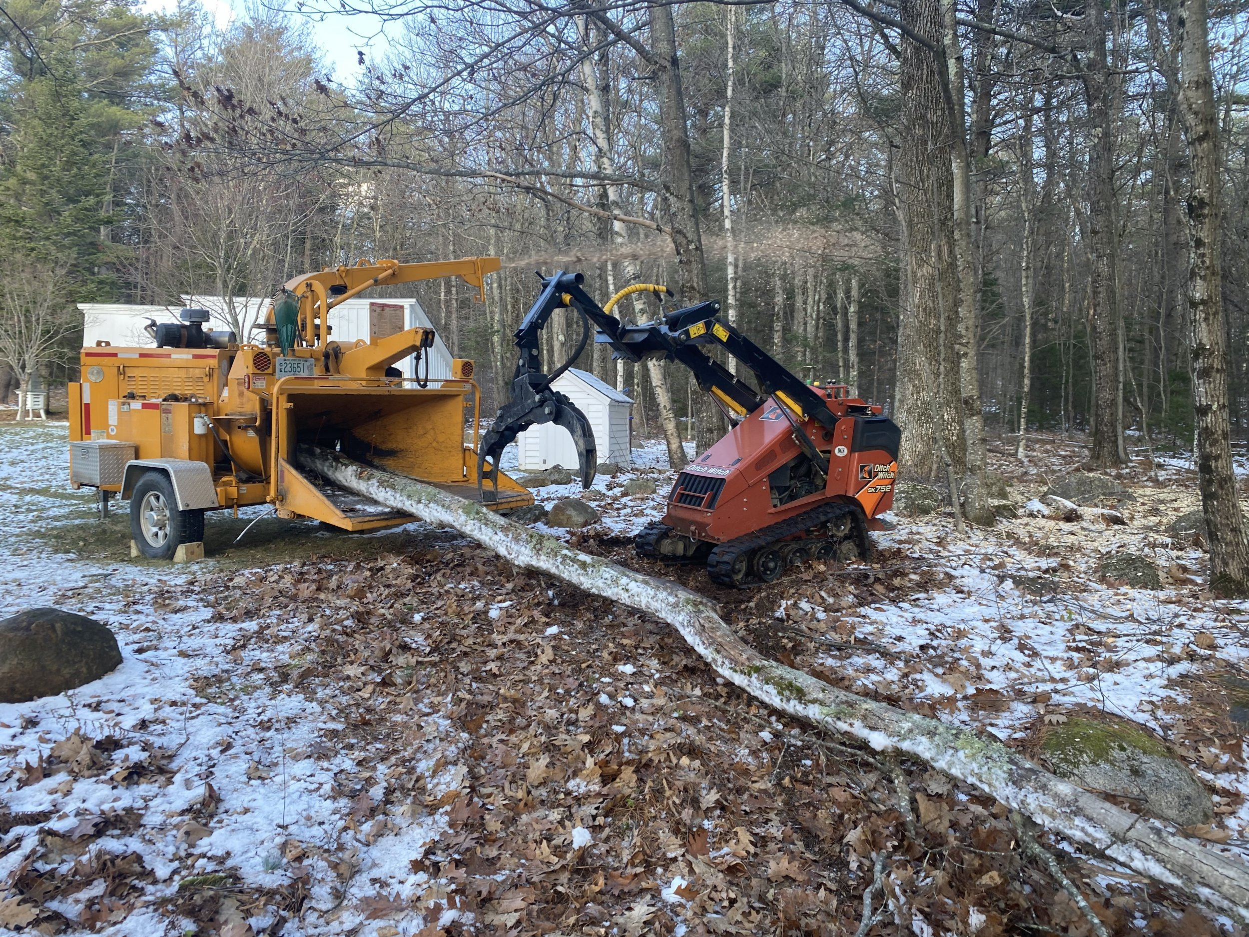

Got a Chinese PTO chipper years ago, but it was as tough as a sneaker. Spent more time working on it than chipping. Sent it away on Craig's list, best day ever. Talked a friend out of his Brush Bandit 250XP. 12" 8 horse Briggs and Stratton
Oh wait , 140 horsepower Cat ! Best day ever again !
