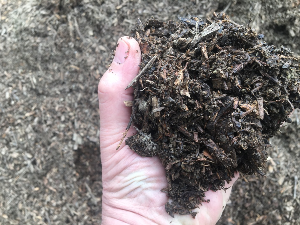

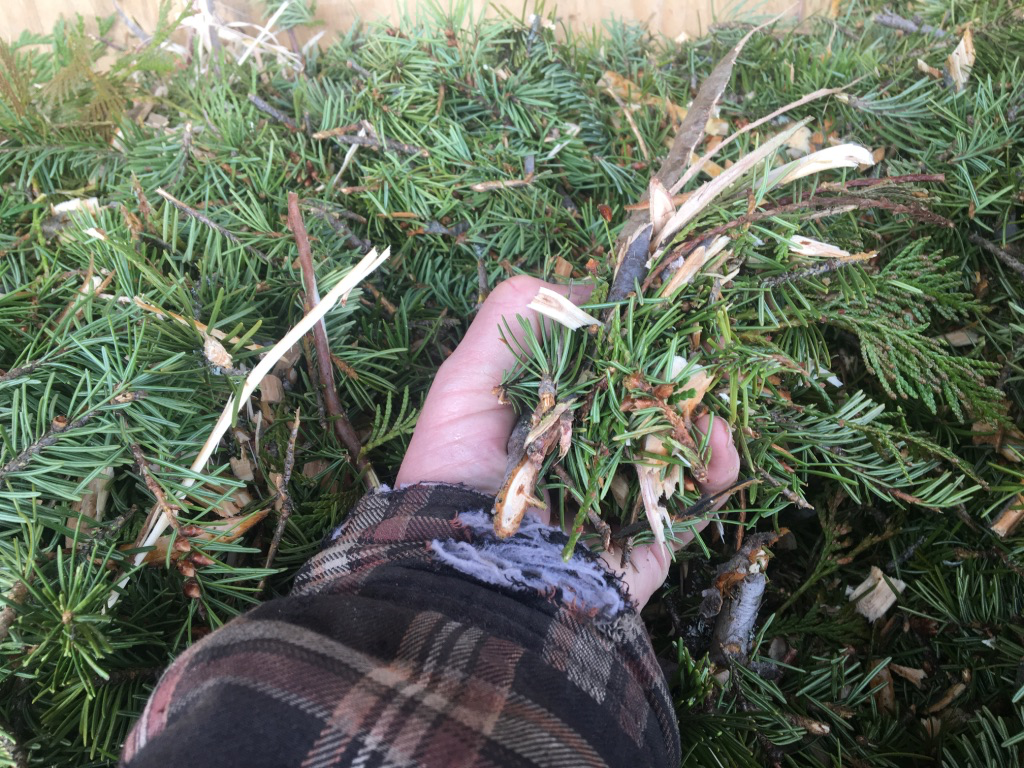

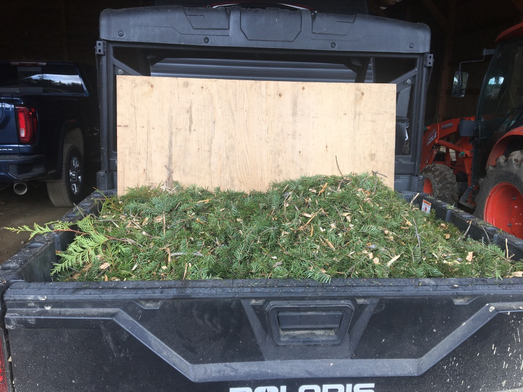

Here are some pics of the stuff I chipped over the last few days with my Beco 4" gravity chipper. These pics don't show the wood chips, since they have been covered by the green branches and tree tops. As you can see these are not finely chopped. There are also a couple of pics showing the material I chipped about 3 years ago and then ran over it with the brush mower to chop it up. This material looks like decent composting materials but I'm a little concerned that nothing has started to grow on that pile.
The trees around here consist of Pine, Spruce, Cedar, Poplar, Birch, Alder and Cottonwood.

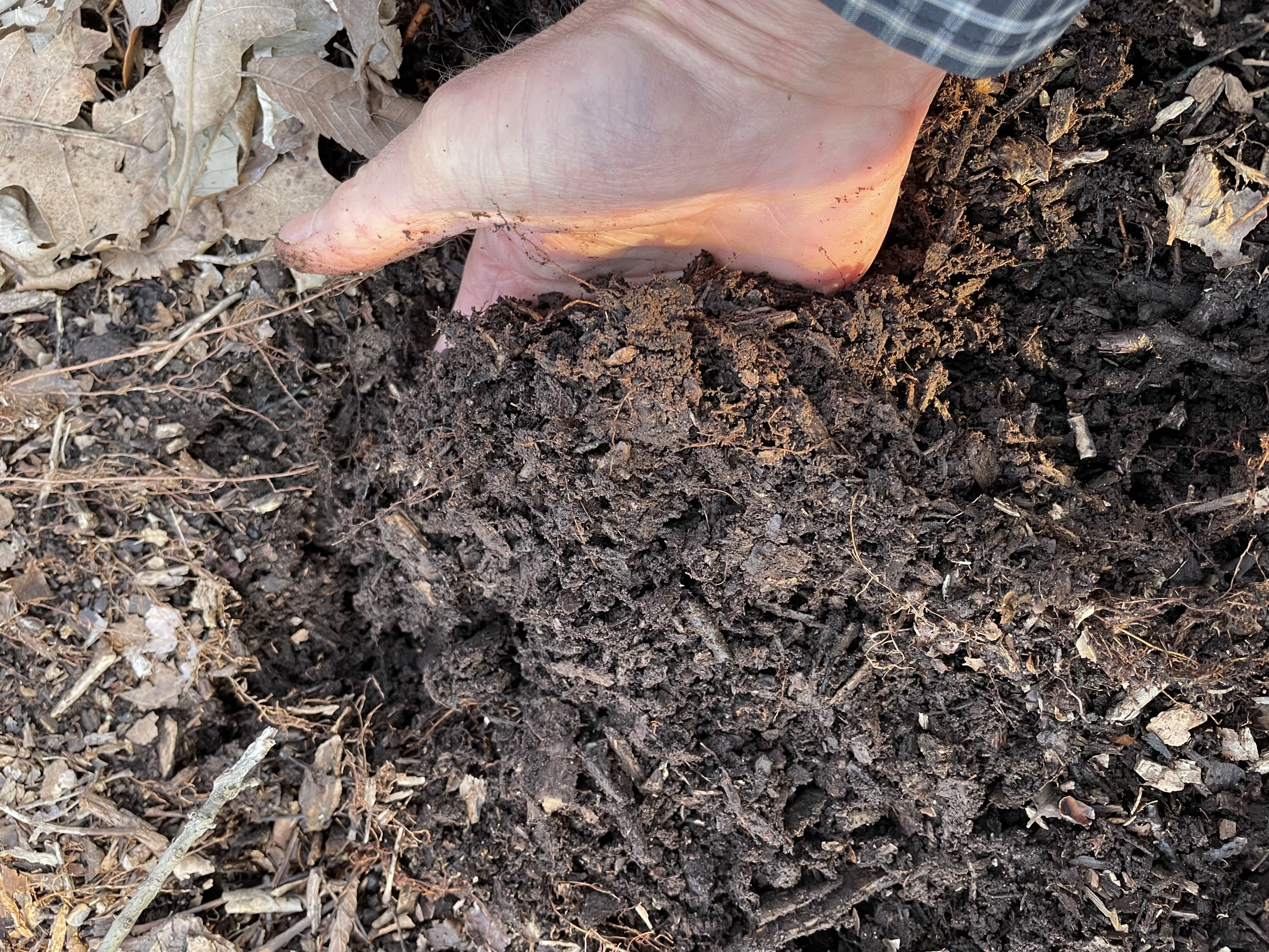

The microbes that digest wood need nitrogen and water to do their job. Put them in a pile and mix in some nitrogen fertilizer and keep it watered. I pile them into natural ravines that channel rainwater. Pine will take a year or two to turn into lovely compost. Hardwoods will take about four years. Cedar will last until the end of time. 😉
The soil in the raised beds is 100% composted wood chips (with some hugelkultur going on at the bottom)

I had to look up hugelkultur and it looks very interesting. Might give it a try and thanks for the info about using nitrogen fertilizer on the wood chips. I thought the green material in the compost pile was the nitrogen supply. Is that wrong? I like your second picture. That looks like very good compost.

Does your WC46 produces compostable sized materials? I've watched all kinds of YT videos showing the Woodland Mills chippers in action but none of them show the chip sizes with any clarity.
View attachment 742434View attachment 742435View attachment 742436View attachment 742437View attachment 742438View attachment 742439
The WC46 at half speed on hydraulic and 450 rpm PTO makes bigger chips that shown.
