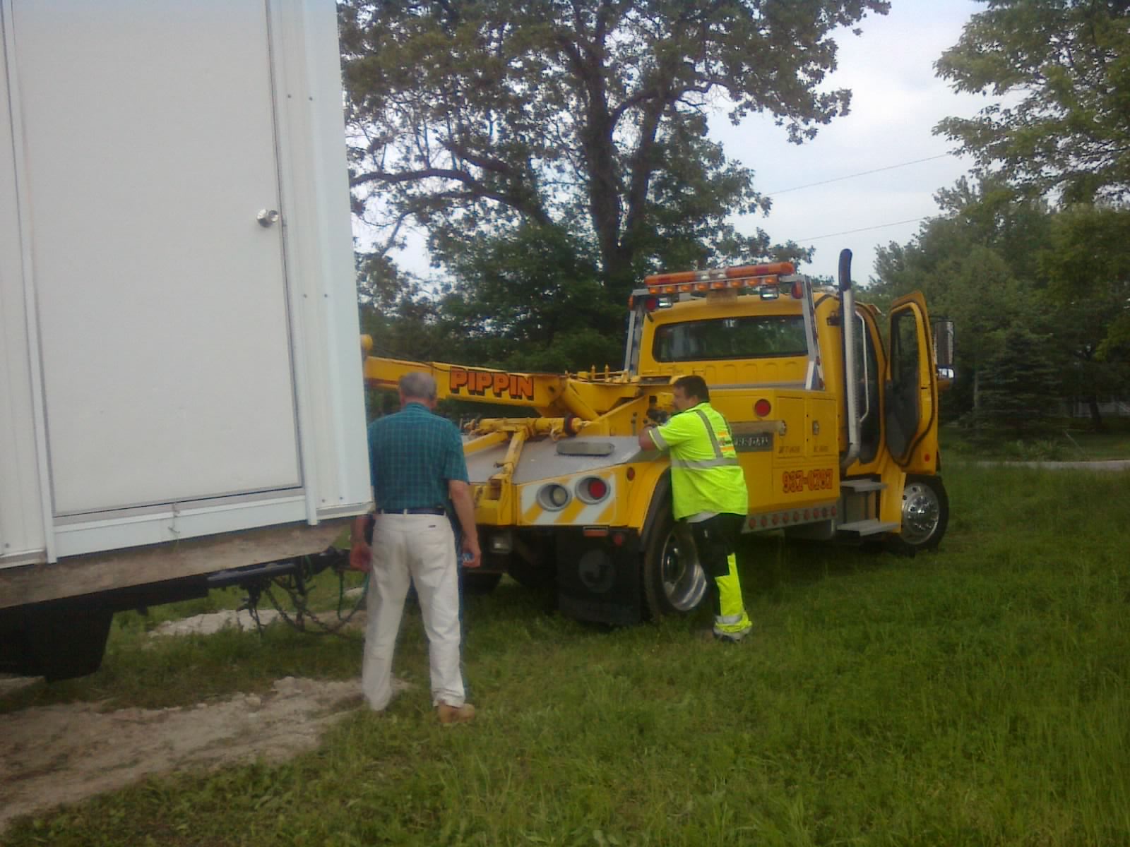

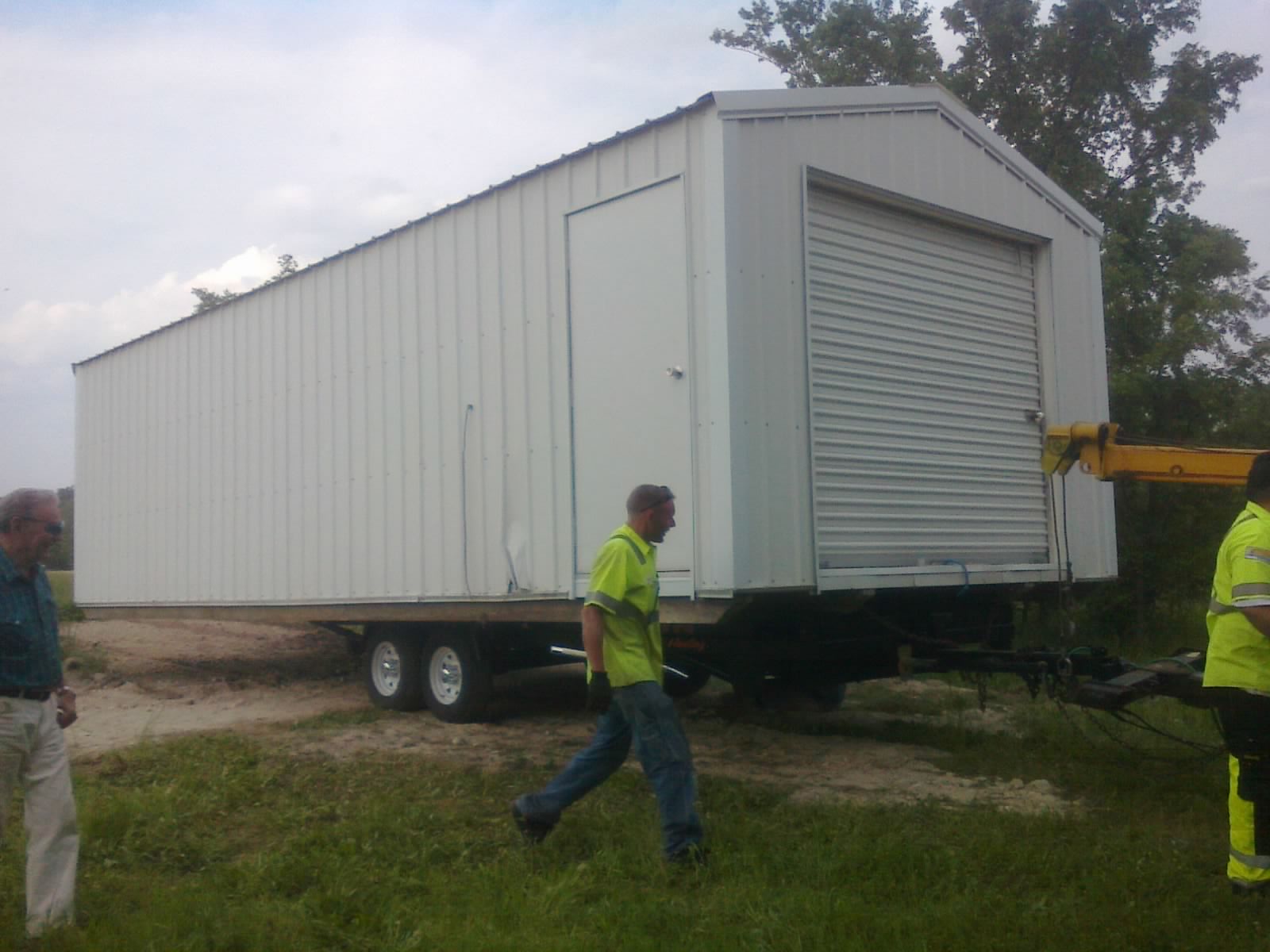

Bought this 12x30 from the neighbor and had it moved about 1000 ft. It has 4 runners that are 4"x6" laminated. Got it for $1200 but it cost $400 to get it moved. They had a trailer with it's own rollback type floor and a winch system. It wouldn't budge the bldg until they hooked the wrecker winch onto it.

I guess it wasn't possible to move using rollers and pulling it with a pickup or tractor.

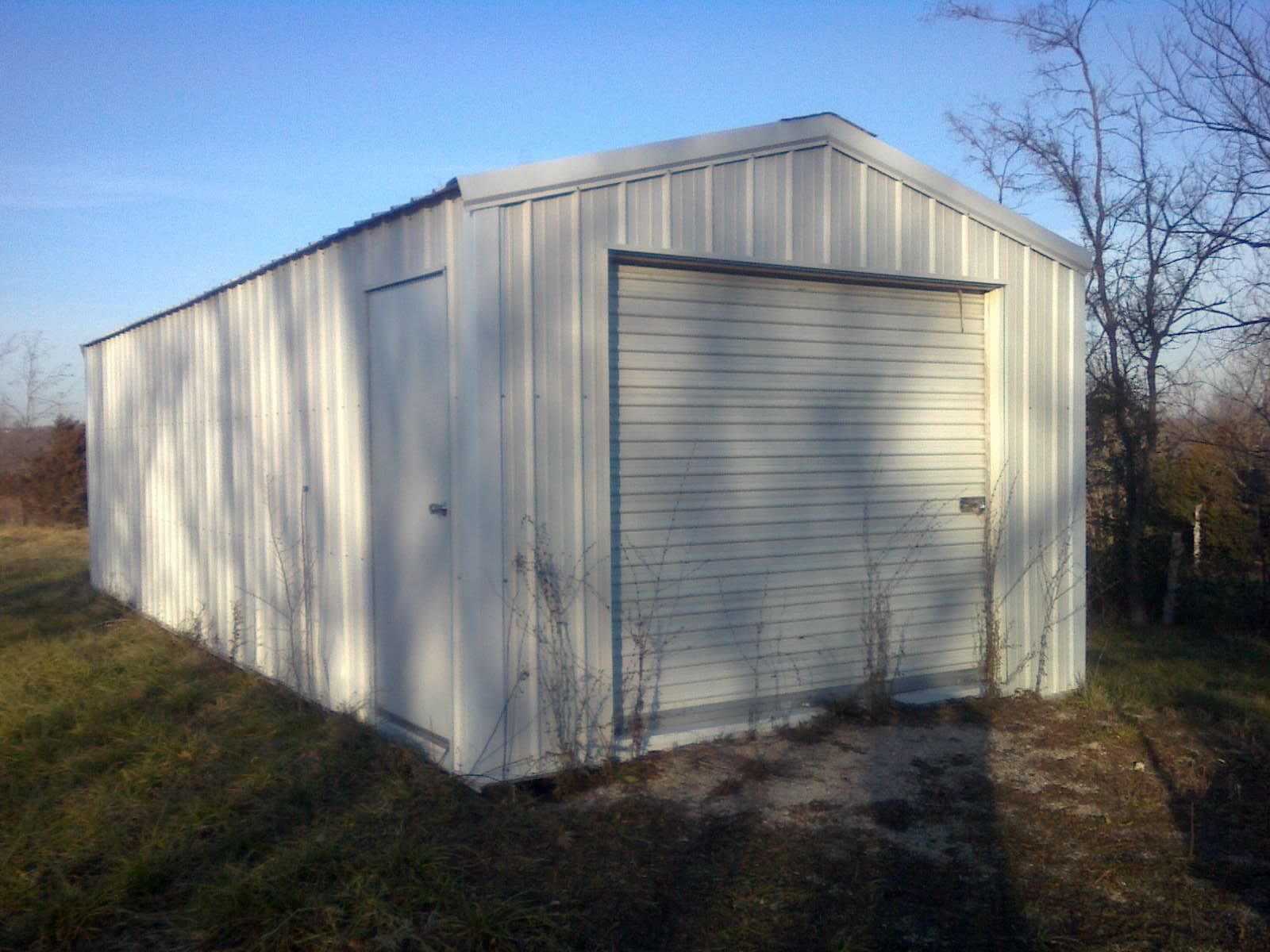

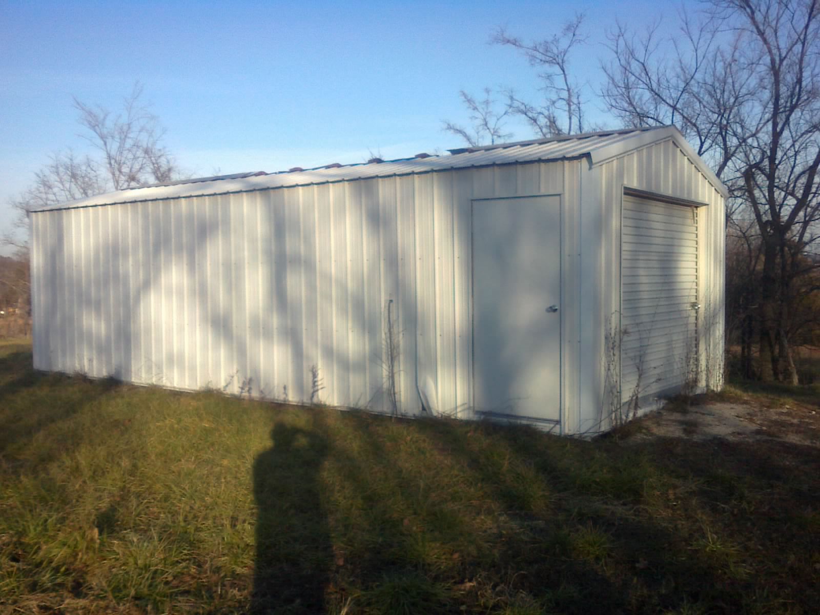

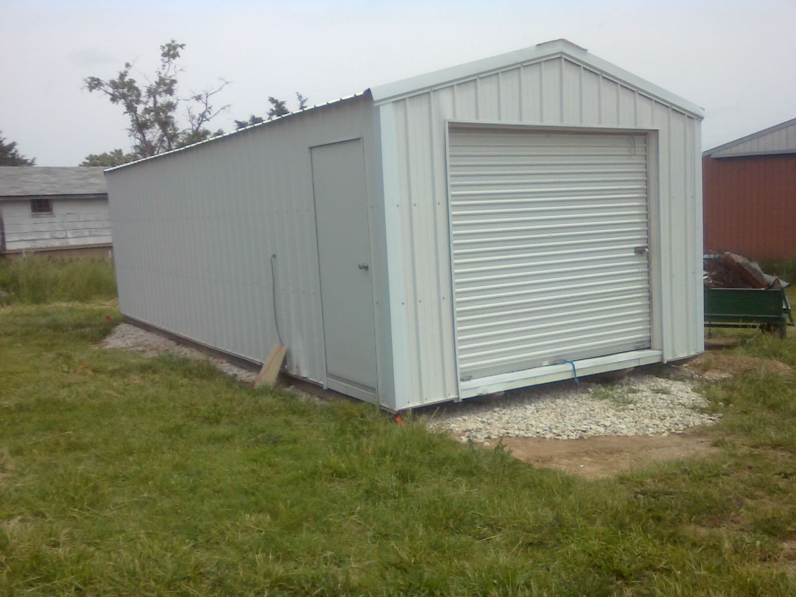

   / Wood framed floor strong enough for a car? #38
The barn is probably designed for terra firma. What happens when it is on terra dulcis or terra lenis?
