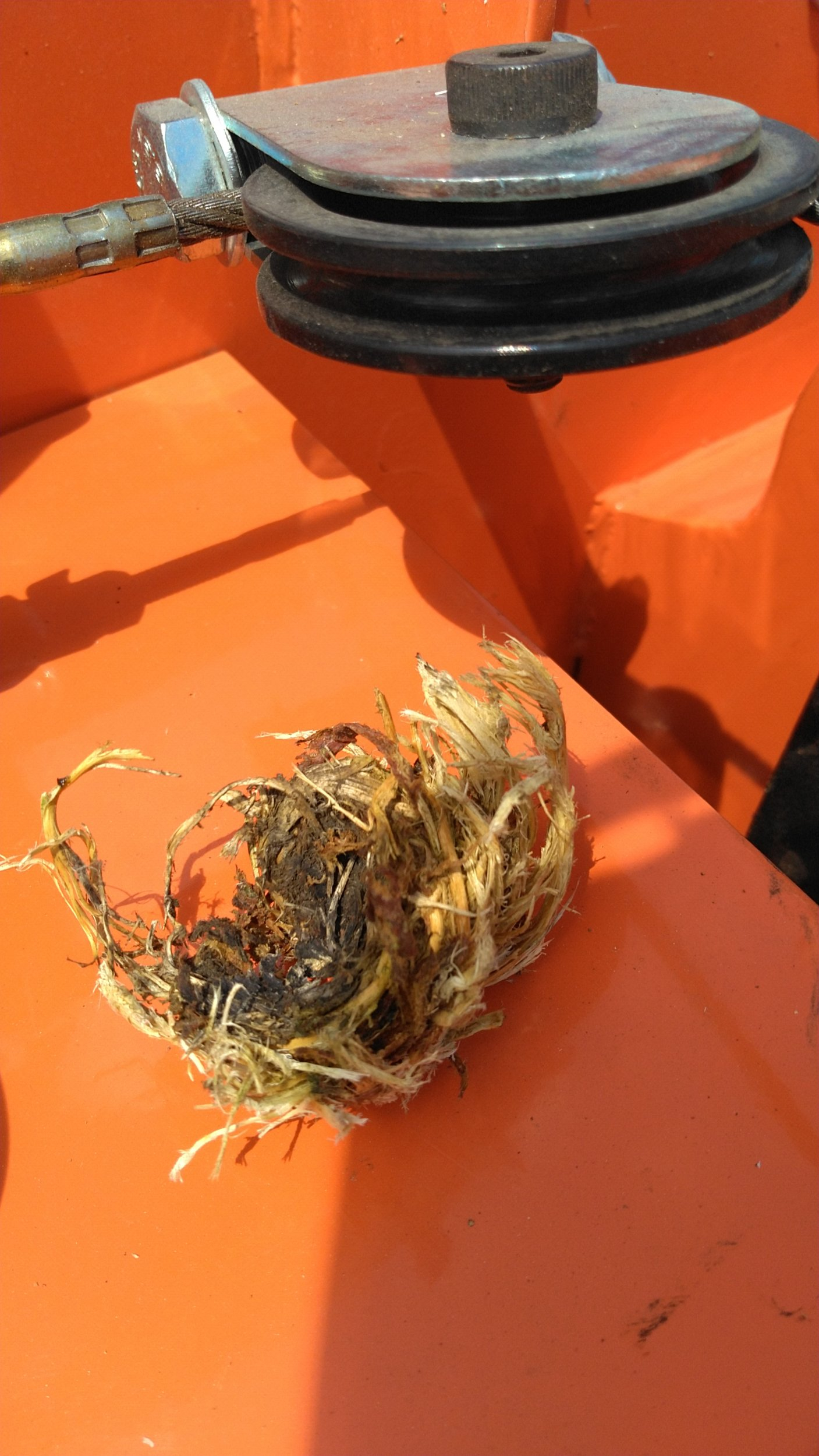

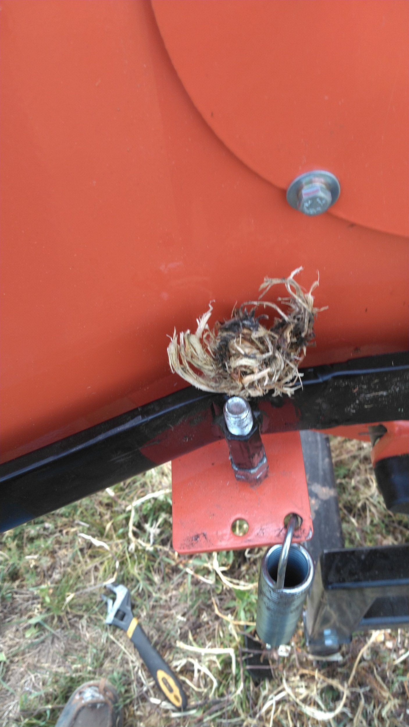

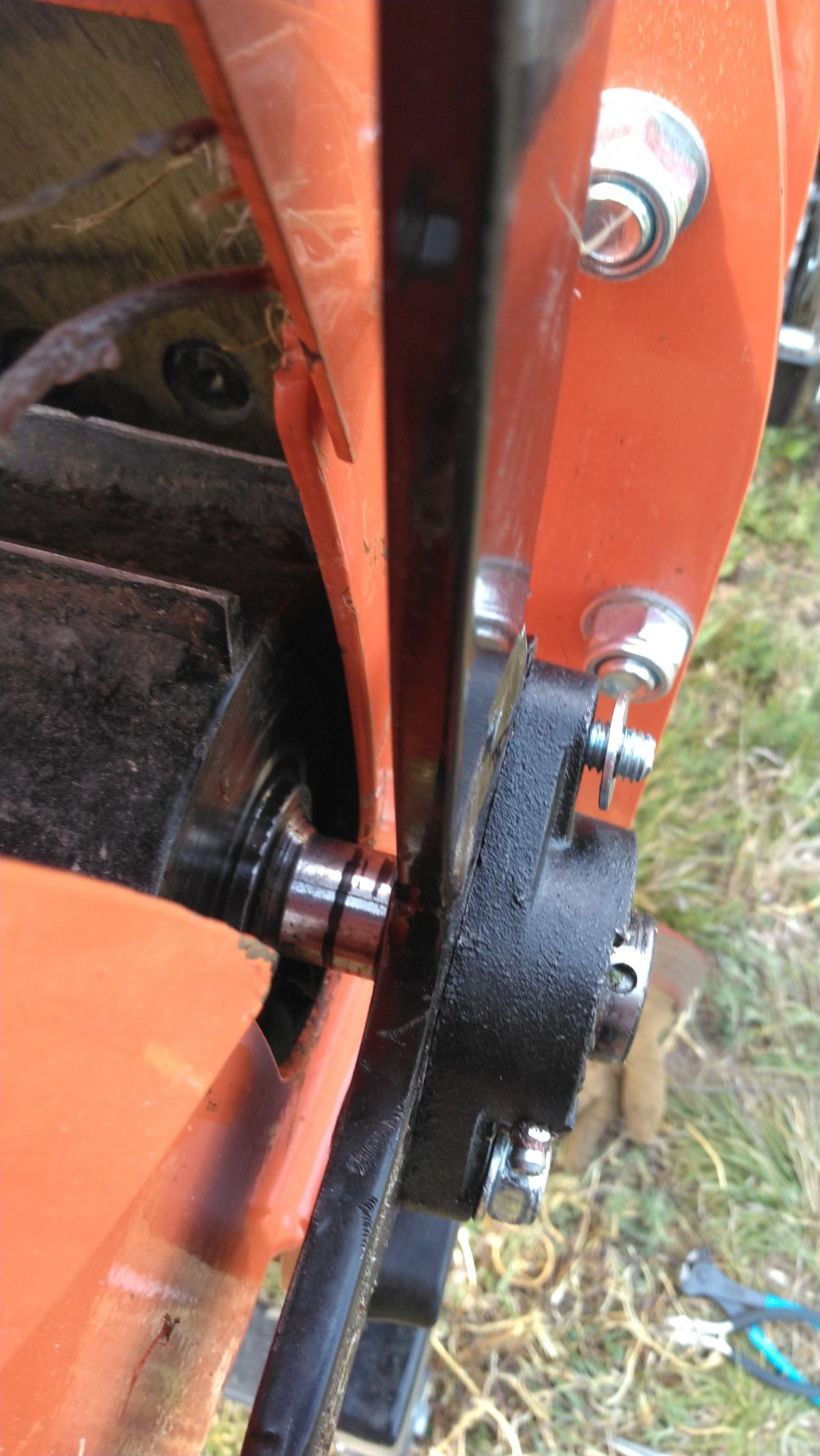

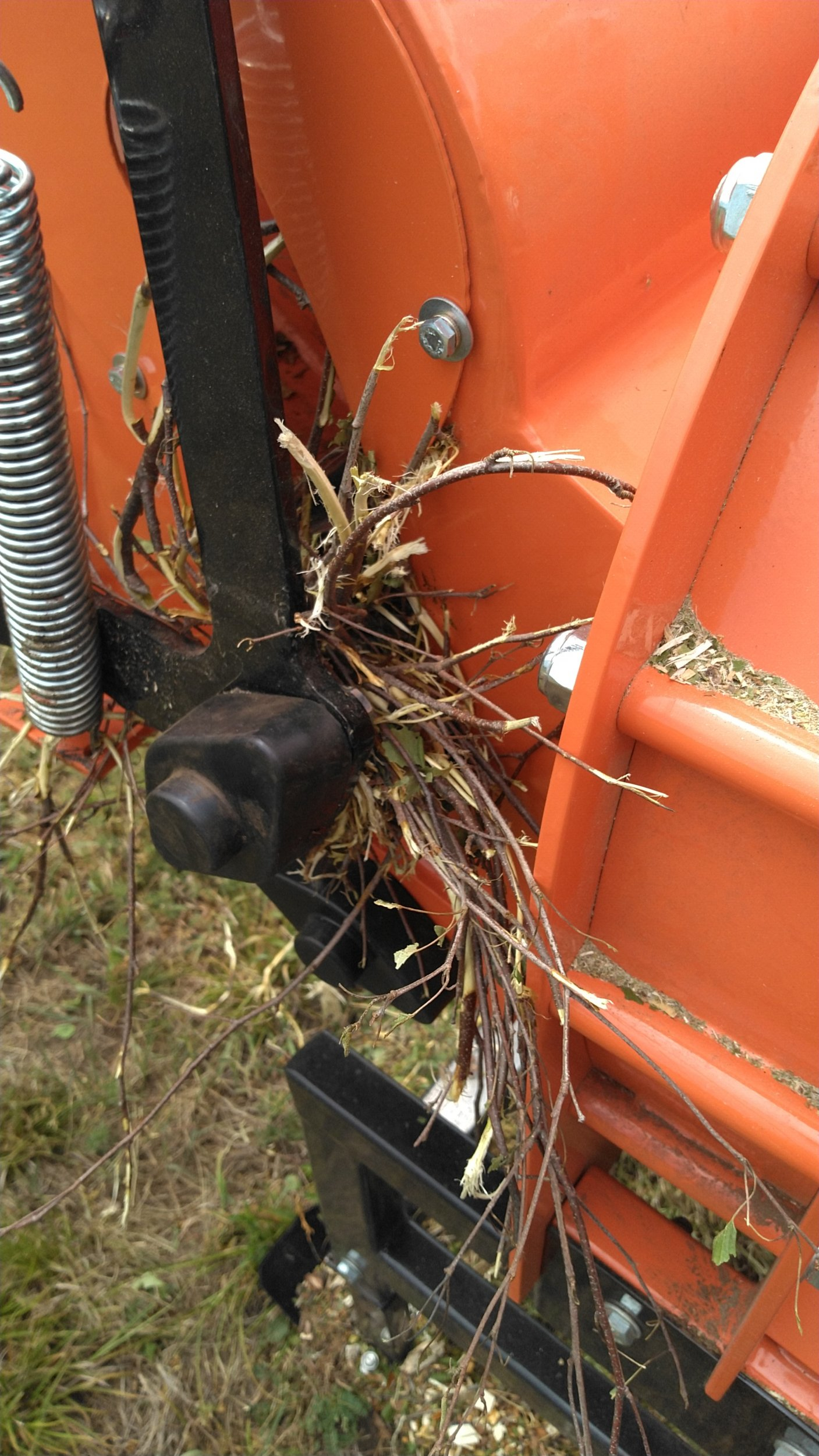

Hi I have a wood max chipper it's been giving me some minor problems with the infeed roller. Basically bark and small branches wrap around the infeed shaft pushing the bearings out of place. I clean them daily which is a pia. but today the debris was so tightly wound it pushed the bearing off the shaft after 4 hrs of chipping. Seeing if anyone who owns one has came up with a solution or has had similar problems? I'm mostly chipping small birch and popple. Insight is appreciated.
Thanks J

Can you let the material dry out before you chip it? I get minor wrapping of small green stuff, but if I pile up my material to be chipped and wait a few weeks, no issues.

I've got close to 80 hours on my 8H, mostly chipping brush. I've not seen more than a small amount of stuff wrapping around the feed roller axle and it's soon gone on it's own. I'm not sure what the fix is.

If you are wrapping the feed roller axle, the knives are dull and stringing the wood chips.

Totally false, I've done that on a brand new set of knives and fresh anvil.
OP, what I've found is anytime I have vine like material it will start to build up pretty quickly. I do my best to throw in a good chunk of material with any vine/stringy material and tangle it up as it feeds if possible. Also if I have to put in a few arm loads of vine/stringy without some solid material I try and put in a good chunk of 2-6" material 4'+ long which seems to clean out the works pretty well.
