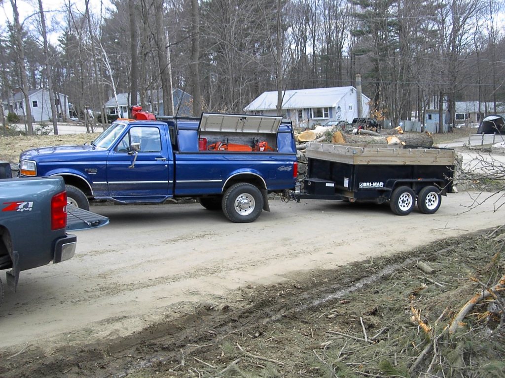

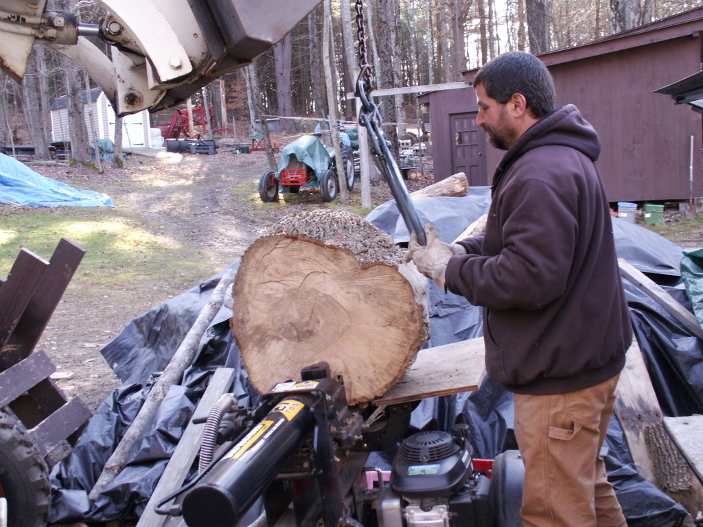

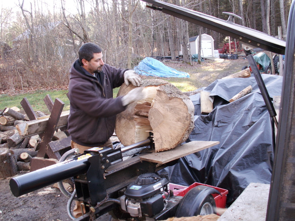

It has always seemed to me that what makes cutting, splitting and stacking more labor intensive is how many times you handle each piece. This year I changed things up and was surprised at how quickly it went. First, I built a set of forks for the front bucket. What this allowed was that I could basically haul back an entire de-limbed tree or more if a smaller tree, cut to maybe 12-15 foot lengths. in one load (maybe a 1/3 cord). Then I cut to splitting length, very close to the splitter which is right next to where I stack. Cutting the logs off the forks works well and saves the chain from going into the ground and it does not get dull nearly as quickly and cutting at a height of 3 feet is a lot easier on the back. I used to cut it to length where the tree was cut, but then I had to load the cut to length logs in the bucket and could not haul nearly as much as I can with the forks and had to make a lot more trips.
I didn't have my forks when I cut my logs this spring, but I do now, and will do what you did. My pile of logs was about 6' high, I cut as much as I could at waist to shoulder height right off the pile.

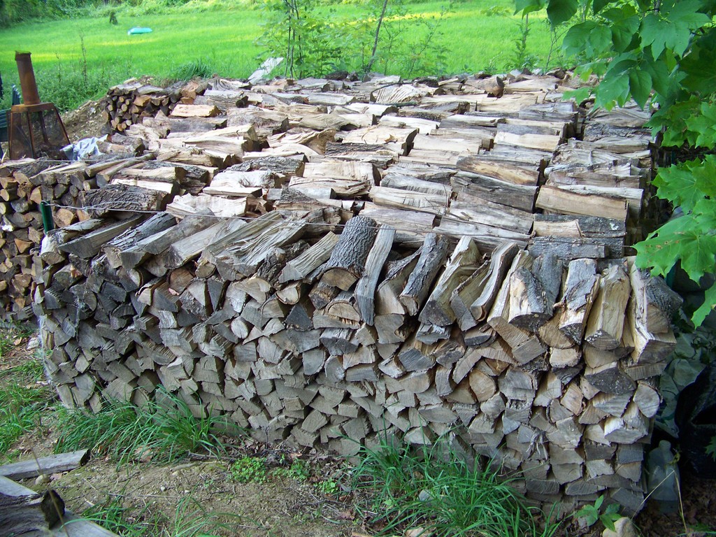

I cut 16 large trees early this spring, and I'm still working on them because we have had a lot of rain... I still have 2 large trees and 3 small ones to cut up, split and stack in the shed... Most of this will be next years wood.
I take my tractor, saw, gas etc.. and I'll go out through the bottom where I cut the trees.. Then I'll cut the top off and push that into a place to burn later.
I then cut up a tree and haul it out in a bottom behind my house, where I split it and then haul it to a woodshed... Most of the trees are very large. The smaller trees I can cut the top off and pull the whole tree out to where I split it.
I use to split all my wood at one time and put all of it in one pile.. It would take months to move and the wood on the bottom would be real wet, and I couldn't use it.
So this year I started doing one tree at a time.. When I haul it out I don't dump it in one big pile.. So when I split it I'll have small piles and it will dry out quick.
I worked most of the day on a very large tree... I got all of it split and then used my firewood trailer to haul 1 load to shed... Tomorrow I'll haul the rest.
Since this wood was cut before the leaves came on, I would probably be able to burn it this year... It's very dry inside and doesn't weigh a lot.. all of this wood is popular.
I handle my firewood too much also, and I do enjoy working on it.. But I wish there was a better way:D

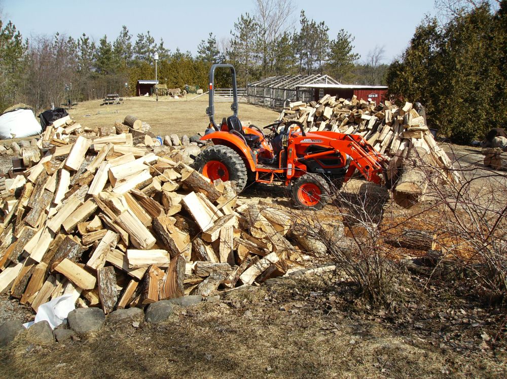

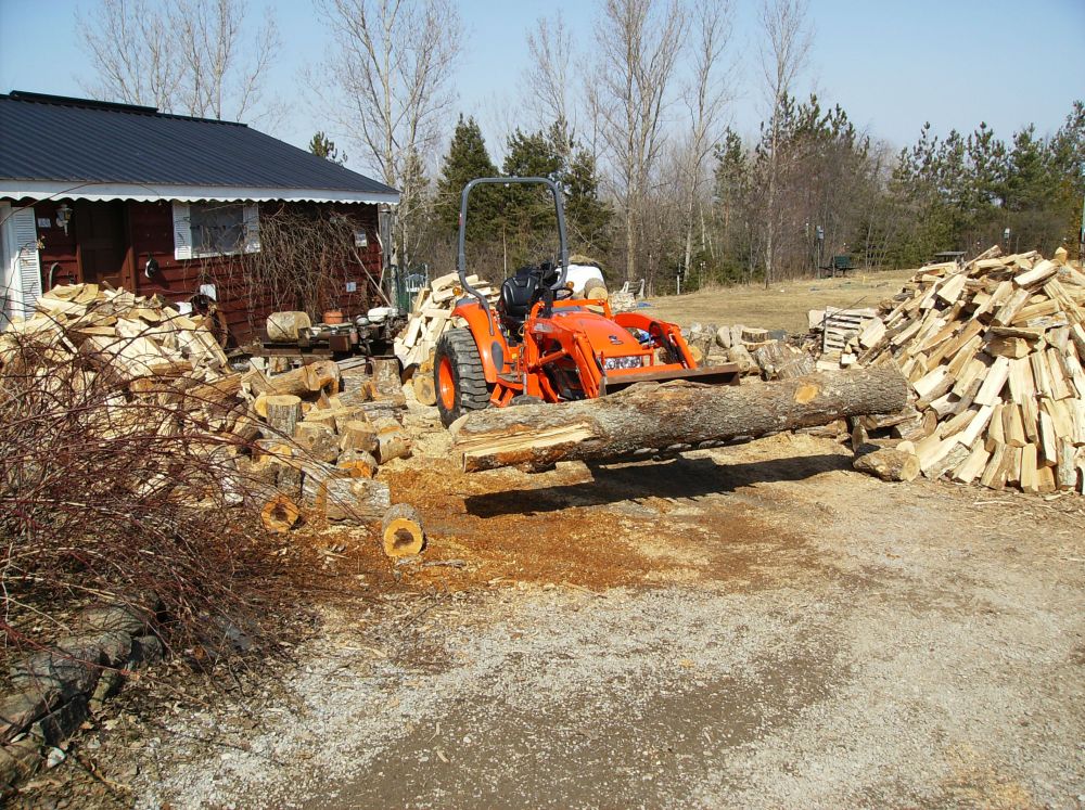

I got another large tree out today... I'll split it tomorrow, and I still have 1 large and 3 smaller ones to go.
It's was hard pulling it down hill because the end would dig into the ground... I was able to cut it in half and pull the top part out to where I do my splitting... I then lifted the bigger end up and put a block under it so I could cut it up.. I had to cut it up where I pulled it down, then haul it out 3 stumps at a time.
When I would lift up on the tree and back up, the tractor would try to flip over... And I remember two members on here that done the big flip... I did have my seat belt on:D
I started on this at 2:00pm and finished at 6:33pm.
Also had some rain last night, and that made it worse trying to get traction... I need to get some AG-tires.
After I get this tree split tomorrow, then I'll start again on another one:D
Life is great!:D

4300,, Nice to see someone else pulls out with the loader.. you seem a bit high with the bucket though :eek:

Bill not to sound like the safety police but it always makes me nervous when I see someone transporting a heavy load with the loader that high. You really raise the center of gravity and it just doesn't take much to send you over. A method I have used is to get the butt of the log in the loader bucket, raise it about 6", get your chain around it and attached to the hooks on your bucket. That will allow you to move with the bucket close to the ground and the center of gravity much lower. Of course you will still want good ballast on the rear of the tractor so as not to over load the front axle with weight.
Looks like you have gotten some nice firewood there.

No problem sounding like the safety police:D... It makes me nervous when lifting something real heavy with the bucket, because accidents happen very quick...I've lifted a lot of trees and can tell when the tractor wants to raise up/flip over, but every time is different and when I start to raise up my bucket I raise it very slow.. That way I can tell what the tractor is going to do.
At first when I tried to pull it with my bucket a little high, and back up, then the tractor tried to flip over, so I had to pull it with my bucket lower.
When I pulled the tree off the hill my bucket was low to the ground...The top part that I pulled to my splitting area was very light..In the picture when I had it lifted up I started to put a block under it and cut it up there, but it being so light I then decided to just pull it out, and I re-hooked my chain to the tree before pulling it...When I lift a tree to block under it I put down my 'backhoe stabilizers,' and that helps some to keep it from flipping over.
When I pulled the top part out I had my bucket low to the ground. (I should have taken a pic)... The other picture where I had the tree pulled out where I do my splitting, I had my bucket high because I lifted my bucket up to get my chain out, and I took that pic to show where I split my wood... But I could have backed up with my bucket low to get my chain out... For the 'ballast' on my tractor when lifting I have my backhoe on.
On the next trees I should be able to pull some, and I'll take some pictures.
/ Wood Processing for burning.. #37
OK Bill, I understand what you were doing better now. I didn't see the backhoe as ballast when I was looking at the photo's and thought you were actually skidding the log with the loader way up there. Glad you didn't take offense at my misunderstanding.
MarkV
