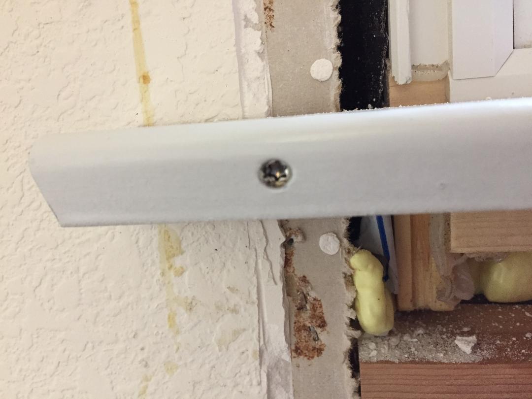

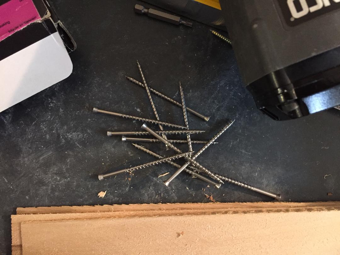

When I first starting working as a teenager, "wood screw" was a clunky triangular thing with a flat blade head. Hard to remove, even harder to drive.
There has been so much progress in this area, and so many excellent screws. I can remember when long "drywall" style Phillips head screws came in, that was a game changer, especially for hanging cabinets.
Today I used wood screws to attach stools to the new windows. They are #7 x 3" stainless steel, with a small trim head, and a T15 socket. Easy to use and extremely strong. Used to be, 10d finish nails were the only choice for this kind of application.

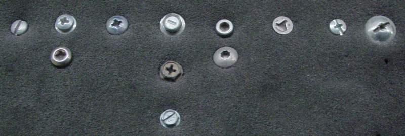

Back about 1985 or so where I worked they wanted to switch screw heads so the robots could more easily assemble the units. I was in the home office service department and a big concern was the service personnel may not have screwdrivers to repair the units and need to buy a bunch of tools, about 5,000 service people. The factory liked the Torx heads but we would need to get screwdrivers for all the service personnel. We finally went with the combination Torx and slot head screws (top right). I made a collection of as many screw heads as I could find - here is a picture. The phillips head looking ones may also be "Posi Drive or Reed and Prince.

What's the one that looks like a Phillips but isn't? Angles are slightly different and a Phillips won't go in all the way.
Then there's another; typical Phillips 'X' pattern with another smaller 'X' pattern that makes it look like a star.
/ Wood Screws #12
Yes X type heads can have different angles and depths like Posi drive and Reed & Prince (common in cars)
The star looking one - please state row and position from the left, not sure which one you are asking about.
Also I think this was before the square heads were made. If you enlarge the picture the heads are easier to see. Ctl + on IE or Chrome
